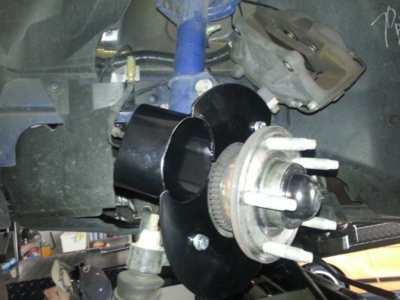

I was at Loran Keller's shop (Open Track Connection) on Friday
...Loran is in the the Dallas, TX area....
and had the Kenny Brown front brake ducting kit AND lower grill installed.
Installation went very smooth. Loran said the Kenny Brown kit is cheaper, and easier to install compared to the Ford racing kit. Loran did install the Ford racing one on another Boss and told me it was a PITA....

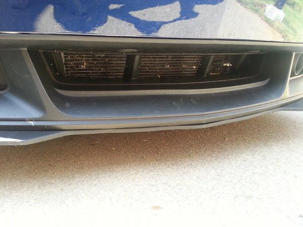

The lower grill was Loran's design and we painted it black using Plastic Dip paint...so it's hard to see it's there....and I figure it will be MUCH easier to clean off the bugs from the grill vs the rad.

As I was writing to say that they are about the same price I checked Ford, to make sure I wouldn't make an *** of myself, and found out they are now 340. I swore for a while they were at 279.99 from Ford. Did you end up getting the special NACA ducts that KB sells? I don't see the reason behind them unless the CS front splitter that people put on the GT's doesn't have a place to put the hoses on over the faux fog lights.

Spindle Mounted Brake Ducts – Retail $179
Neoprene Hose – $64.95
4 Hose clamps are included

Yeah that's significantly cheaper, especially with the new price increase. Though I would have gone with the aircraft hose since people have said it lasts much longer. Are you installing it yourself or having a shop do it.
