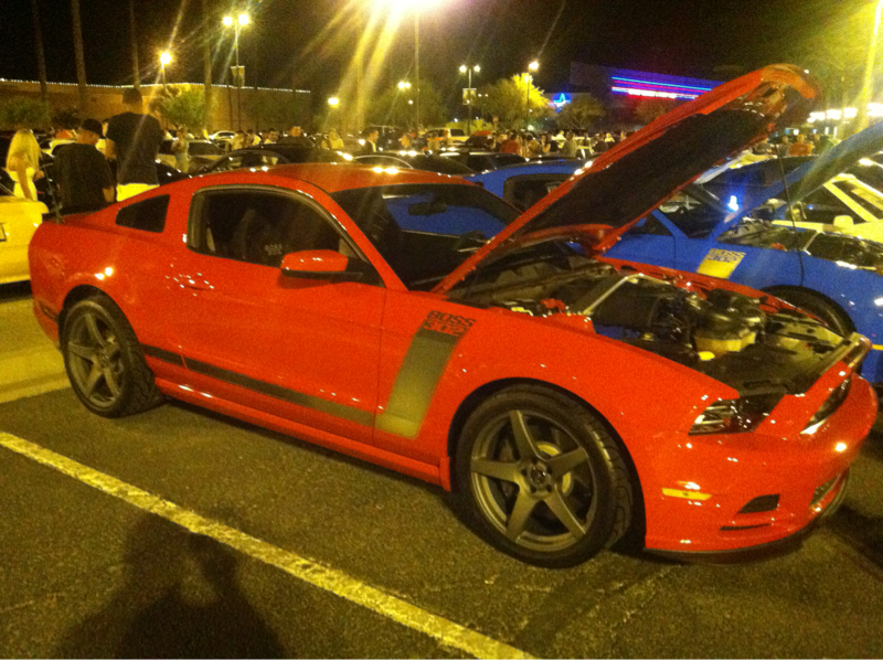

Forgestar CF5 / 19X9.5 all the way around with 285/35/19's.....just we'd to drop it a bit.....the gunmetal goes well with the stripes.

looks awesome.

I'm considering the same set-up with 285/35/19's. What model tire did you go with? rim offset? I like the fact you can rotate tires now. Looks good!

I went with BFGoodrich KDW's....the offset is +33 all the way around. The edge of the tires/wheels line up with the front and rear fenders. I was told if the car was lowered more than 1 1/2" that there might be some problems up front....I plan on lowering the rear, but that's it.

the size and offsets look great. i think i'm going to replace my cf5s over the winter maybe I'll just do the fronts with this size.

What I was going for was the same concave all the way around. A few places said what Forgestar calls the deep concave wouldn't work in the front because of the Brembos....I ordered from Howey Industries after they said it would work all the way around. They were great to deal with. I also learned the RTR rims in 19X9.5 have the same offsets, hence why they only sell that one size to be used all the way around. If you want any more pictures to see how they fit let me know.

They look great!

I've been eyeballing these (in black) for mine for a while as well... LOVE the look!

I probably would have gone matte black but it's a nice wheel regardless.

Awesome looking wheels, I personally love the gunmetal finish
