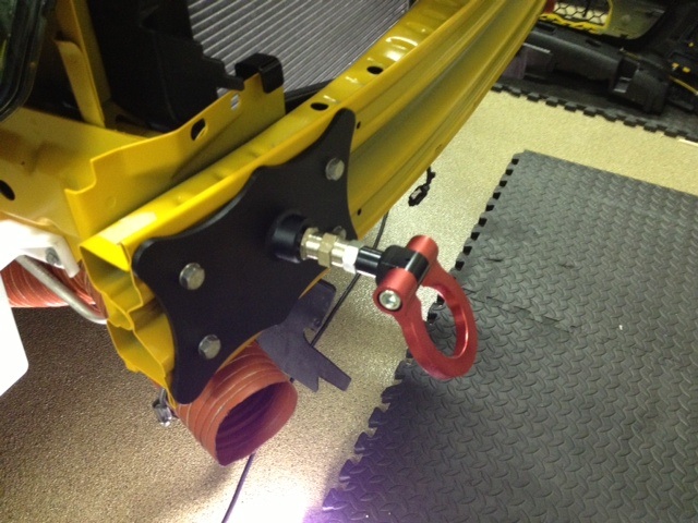

Got mine torn apart and have the front plate on, but the 2013 bumper foam is different. I have an email out to cooltech to verify how to proceed.

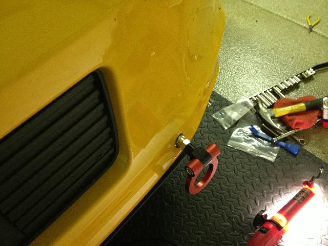

Progress. The 2013 front end is different from the 2012. The depth from the front of the bumper skin to the actual bumper is deeper and the push in foam retainers are behind the boss plate after installation. I was able to get everything mounted up and fit but I had to back out the tow ring eye 3/8" to get the shaft to seat against the boss. I don't think it's safe to tow as is since there's not much thread left in the toe ring. I've been in touch with Kendall at cooltech and I'm sure he'll come up with something. A 1/2" longer shaft is the easiest solution.
After going through all this it seems the 2013 might be prepped for a tow ring since the foam has a significant recess ( see previous post) with a nice hole through the foam dead center. Future factory kit??
Pics to follow.

John, thanks for the pioneering work and sorry forthe trouble. We had ordered (or thought we had) the foam for a 2013 and when it came in, it was the same as the '12 - presumbly showing the hooks would be the same. After John contacted us, we discovered that we had, in fact, ordered the 2012 foam duh!
We will have 2013-specific plates next week for the front with a boss that is 1" longer. We'll get one out to John asap and to anyone else that has a 2013. Again, we apologize for the inconvenience.

I was hoping for a longer shaft on the ring. I just got her all put back together.
Oh well, appreciate the help and quick response
