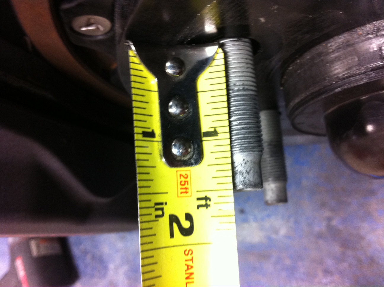

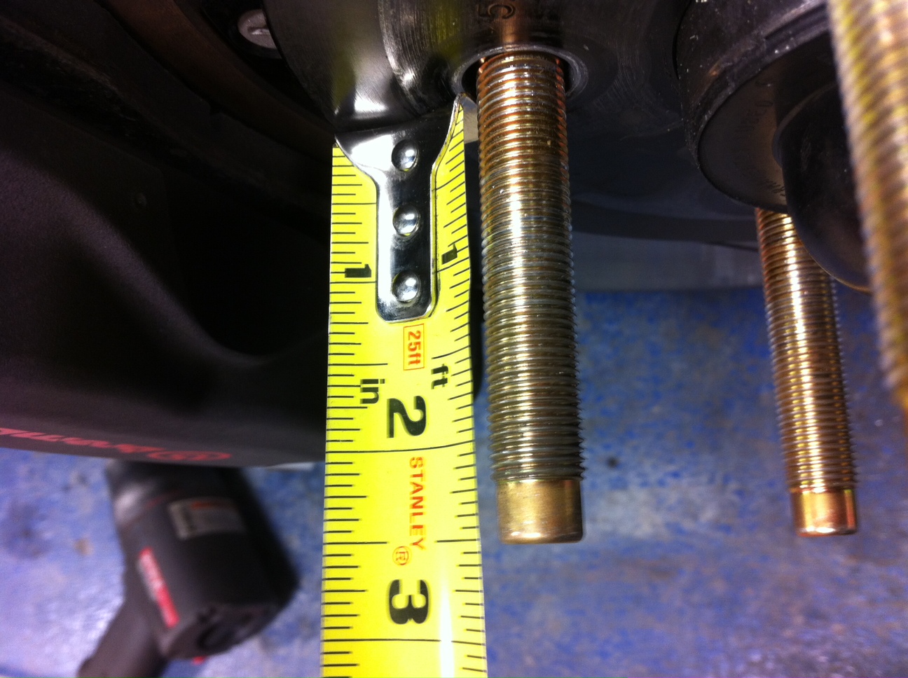

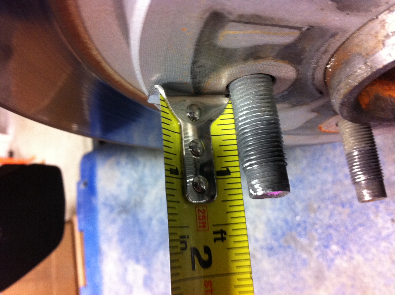

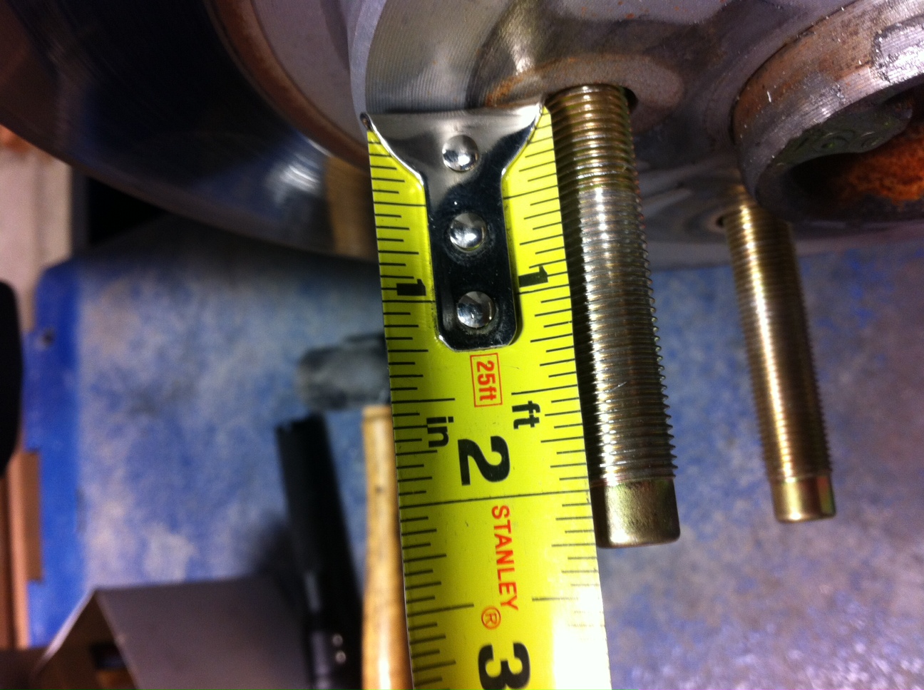

I'm not sure of all the reasons that the studs are so long but they certainly had a choice of what length to use. Look are subjective... I think the look killer. Very serious. I don't know where it rtanks on the list of "whys", but the added length makes it such that the wheel will NOT fall off once you lift it up and set it on the studs. Also, it is easier to avoid hitting the caliper and scratching the caliper, the wheel, or both.
How long does the stock stud protrude measured from the rotor hat?
Front Before
Front After
Rear Before
Rear After

Kendall - thank you so much ! I didn't realize the rears were shorter.
