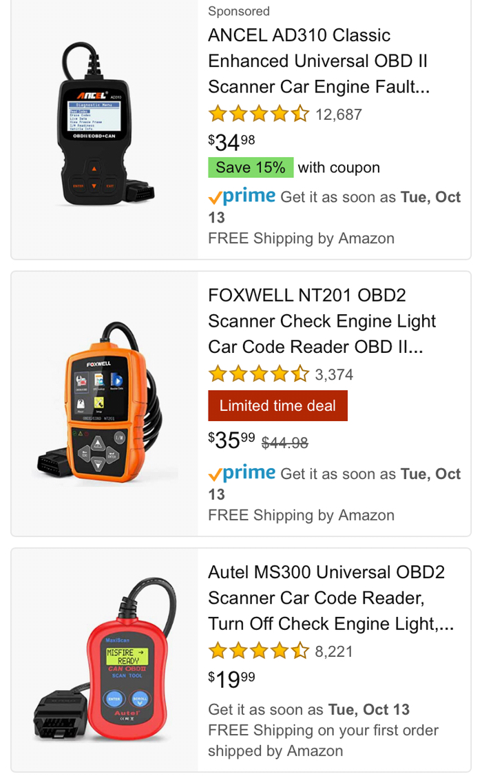

So do you recommend any of these engine code readers?

Without any experience, I cannot recommend any of those... but I'm sure any of those can do the job. Possibly.
You need one that'll show you the codes and also that'll erase them. Some are more capable than others. I have this one:
https://www.harborfreight.com/automo...abs-63807.html
It works well enough for what I need to do. Can't say it's fancy, but it does some live data, logging, and abs, so that's good enough. If not... I'll have to get another or go to a shop what does have better. For scanning/diagnosing the SRS perhaps.
