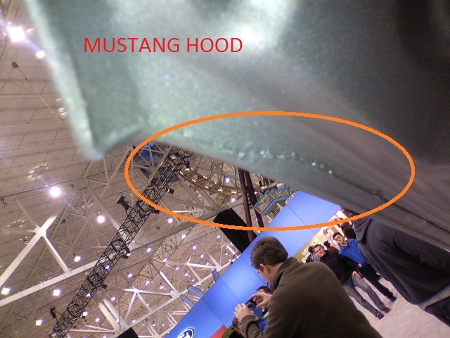

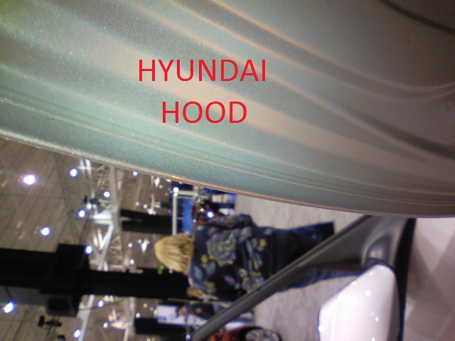

got to see quite a few new mustangs at the Cleveland auto show yesterday, hoods definitely better than last years show- only the blue one had what looked like the old bubbling beginning, and it was at a back corner- the front seams were definitely better, didnt see any missed/holes like last year.
did see one other spot that looked/felt just like the initial bubbling on my hoods- but on a fender of a red mustang...small area, but looked just like the old hood issue before it blossomed
one thing that i really disliked- the quarter panel seams under the trunklid on the fastbacks were all nice- but on both convertibles displayed, both sides looked like bird crap, but messier. pretty obvious whoever was on the 'vert line dont care much as to what their work looks like... truly a shame they painted over that mess rather than smooth it out at least a little bit. only put a pic of the blue one, the other was too much glare, but was every bit as sloppy.
I'd rate seam/sealing/paint best this year on Scion, followed by hyundai and volvo. Ford definitely was the worst, only one I saw on display without at least a few WTF areas was a F350 duallie- obviously not from the messy F150 line, the dually was about perfect. I'll toss some aluminum F150 pics in too- boy, the bubbled up area around that bolt on that military grade aluminum fender looks/feels just like a blistering mustang hood... and the last pic with dirt/sharp edges felt a lot like the sharp areas around the hems on my mustang hoods where the corrosion started...hmm
