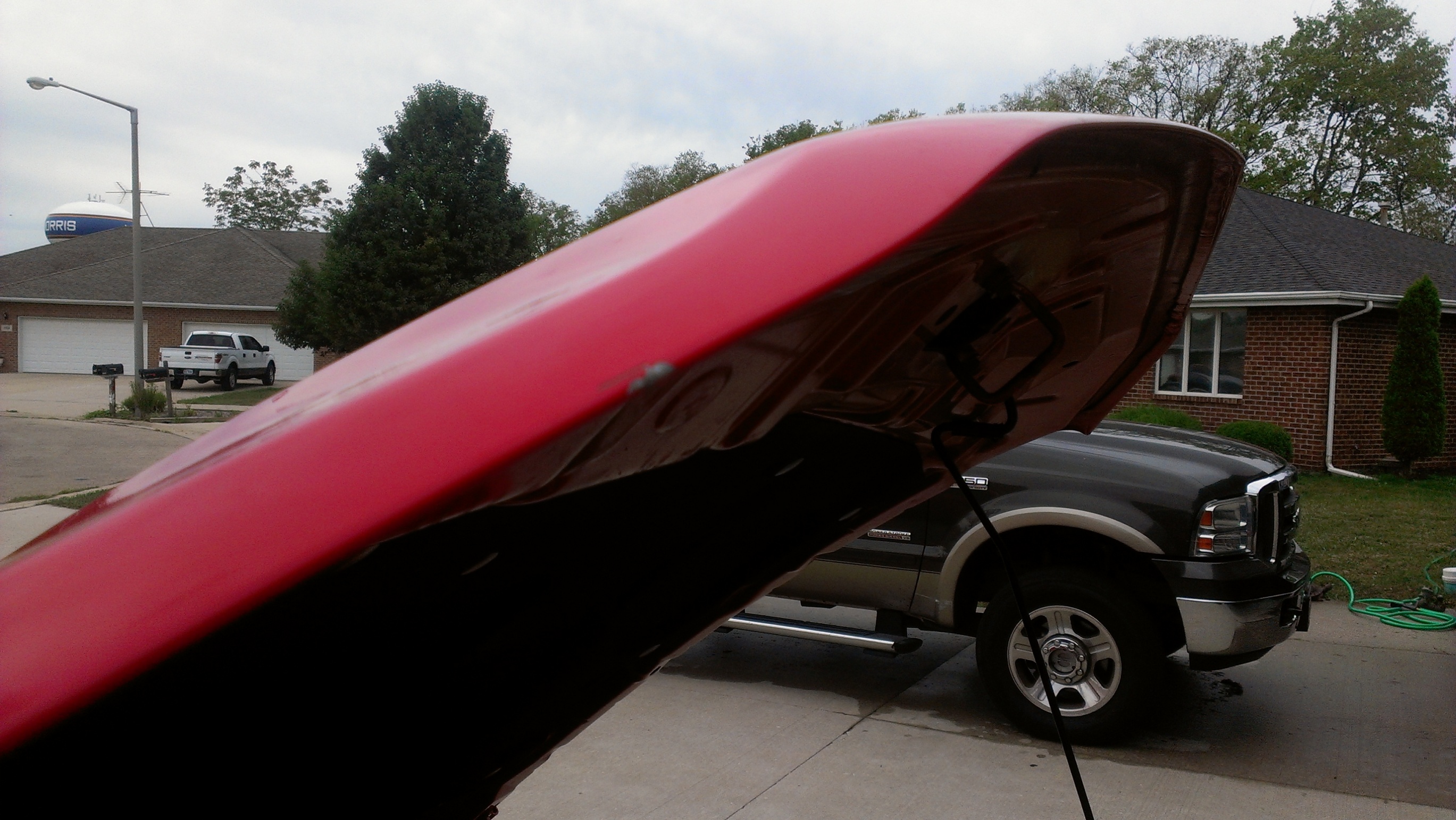

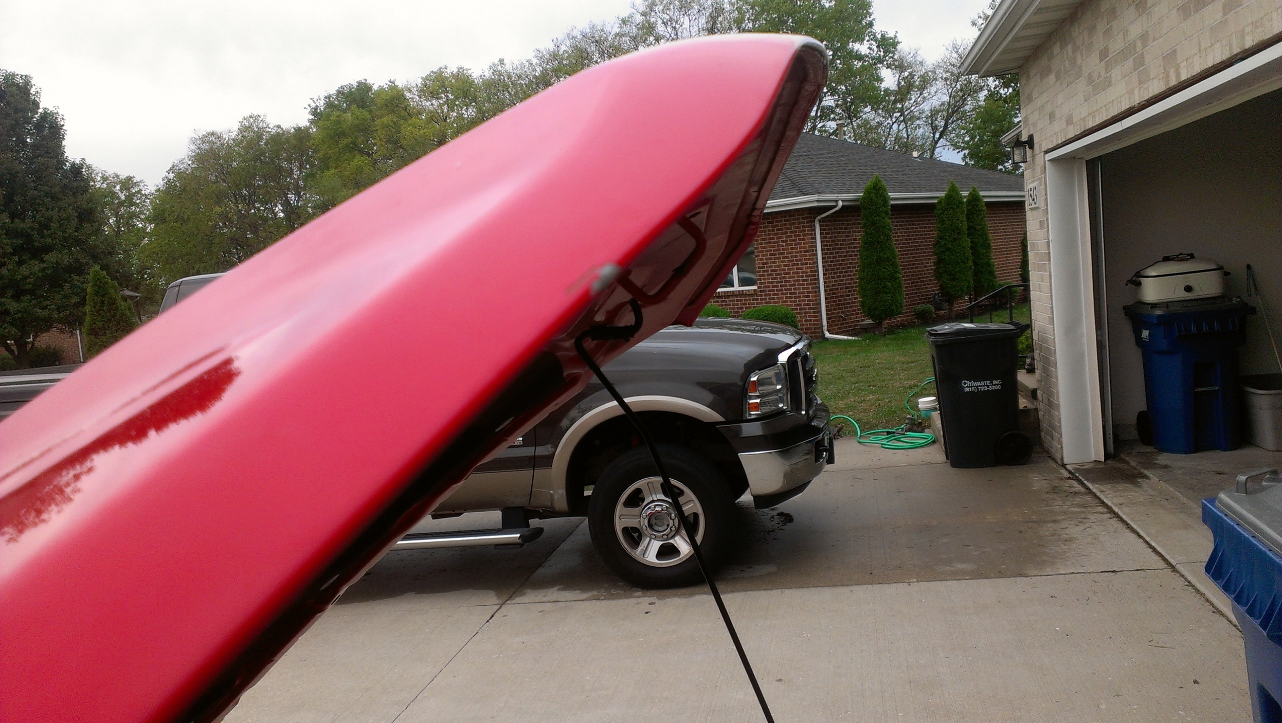

Noticed the other day some bubbling on the hood at the front by the passenger headlight. Looked even further and there is some more along the front underneath. Today at the car wash the paint has now come off. This car has never seen snow and MAYBE rain once. Garage kept, washed and waxed. Needless to say I'm very pissed because I know Ford will try to stick it in my a$$ on this one. Car has only 9500 miles and the paint is bubbling and falling off. WOW! I know there is a TSB for this correct? And I know Ford will try to repair and it will return later so I want a new hood and NOT a rotting Ford one. Anybody just get the repair cost from Ford and go buy there own? I mean if a new Ford hood is $1500 and paint is $500 i'll just save Ford some money and go aftermarket for much less.

they wouldnt get a brand new hood, just refinish this one.. I have a few spots on my hood, but i think its from highway driving...

First, calm down.
Second, get it repainted. That is all you can do. It *is* under warranty, as you should have a 5 year B-B. This is a known issue with these hoods, they WILL repaint it free.
They will redo your hood, they will not give you another. The hood is not rotting. The paint is delaminating from the hood due to bad paint processes, caused by incomplete cleaning of the hood when they do the seam sealant, which is why it bubbles out from the edges... the seam sealant is leaking back out, and causing the paint to lift off.
It has been known for these Mustangs since 2005. As long as Ford uses the same processes and rolls the dice on which hoods don't exhibit the problem (which, I suppose, is most of them, to hear the lack of complaining) and uses aluminum for the hood, there will be bubbling.
A properly repainted hood will likely NEVER bubble again. The key, though, is to ensure the aluminum is pristine, untouched by anything except good primer and paint, uncontaminated in any way. So pick a good dealer's shop and let 'em have it. And stick Ford with the rental bill.
