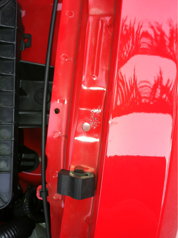

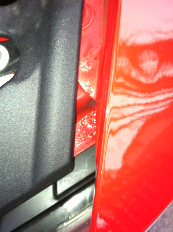

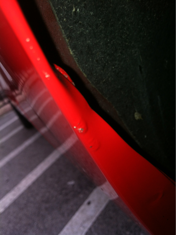

My car is 3 months old. There seems to be a couple raised sections and some of the paint is coming off on these raised section. It's in the engine bay and on the lip of the wheel well. Is this something ford will warranty? It looks like a paint defect for sure.I'm pretty upset about it, because to fix the wheel well they will have to respray the entire quarter panel and then blend further up. The only upside to them having to paint the quarter panel is that it'll fix a rock chip I have further up in the wheel well. What do you guys think? Let me know what you think I should do.

Almost looks like what happens when you spray paint over a silicone contaminated surface or something. Wonder if handprints or contamination got on panels before they were painted.

Totally agree^ that's exactly what causes that. Improper prepping and outside contamination. The first pic looks like a fish eye. (Run)
That's just sloppy. Sorry hear that bro. That would keep me up at night. Hoping for the best for you.
