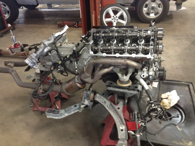

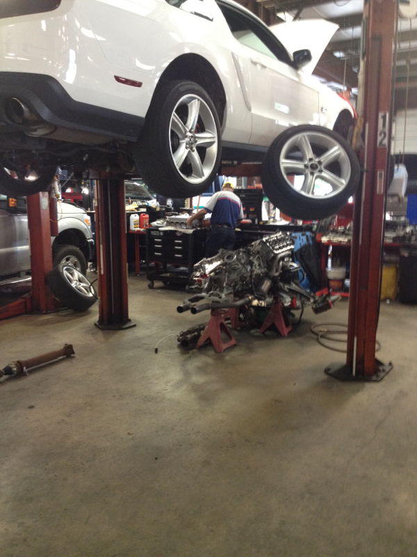

I'm ready for it. Went to check on it today. Motor still on the ground.
Attached Thumbnails My #8 failured on my stock 5.0-image-3498515536.jpg   My #8 failured on my stock 5.0-image-1514409452.jpg

wtf is the wheel hanging on the lift? sad to see the motor onthe ground
Yeah if it wasn't at ford for warranty work I'd say its a good time for headers
