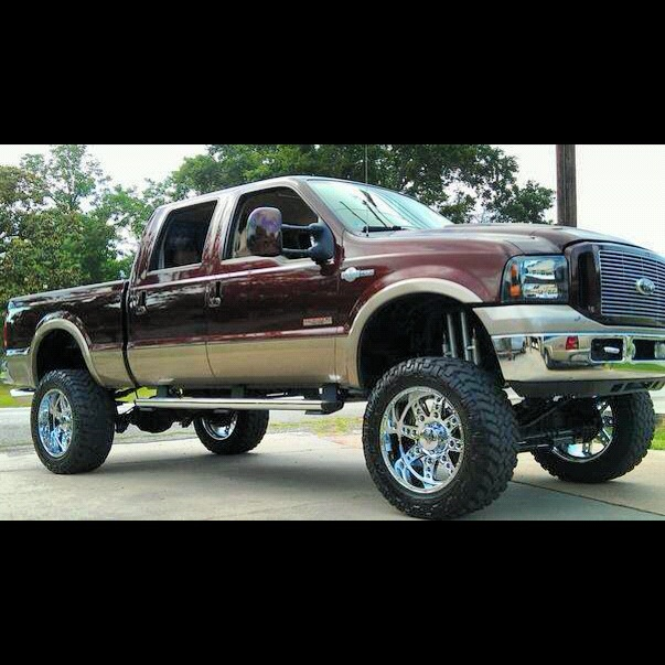

No it's just that after having a 6.0 and doing a bunch of motor **** which voided the warranty it cost me 10 grand out of pocket to fix it after I lifted and cracked the heads. So this time I decided to wait for my warranty to end before putting performance stuff in it. Although that truck is still my favorite vehicle to this day.

Thats a very nice truck.

The worst part is a local guy bought it. So I se it all the time and it drives me nuts.

Nice rig! I feel ya on the truck that's why I will not sell mine, I'd cry if I ever saw it on the street again. Mines a Silver 06' 6ohhhhhh and yes I will not be modding my new Mustang when I get it till it's out of warranty. Good luck with your car and I hope they make it right for ya man.....Here's a lil kick in the butt for dumping that truck....lol
I hate to do it to ya but I do love the Superduty and you sir had a fine one....Best of luck brother.....
