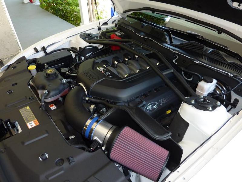

I cut out the hood blanket, "rain catcher," around the vents to let out even more heat, and I still don't have this problem.
After you did that, are you having any issues during rain with cai.
My C&L CAI has a water diversion design, so it stays dry.
