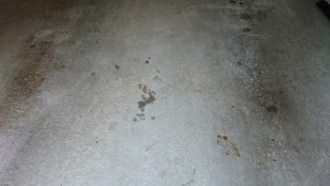

Differential whine + leaking (photo inside)

Ford changed the viscosity of the oil to get rid of the whine as "pinion leak" (under warranty) but the problem is much more than that; there's physical leakage. I can't hoist the car to see underneath but black oil in middle is obvious as another fellow with the pinion leak topic. It's in the shop today again. The whine occurs exactly at 40 mph (60 kph) only at acceleration at that speed and is audible with radio on it windows down. It doesn't happen during deceleration. My Corsa xtremes have been sitting in the trunk for 2 weeks waiting for this to be resolved.
For the record I have 3.73 6mt.
Problems I had so far are:
Engine knocking tsb: new short block replacement
#2 and #8 misfire
3.73 whine and pinion leak
Attached Thumbnails Differential whine + leaking (photo inside)-dsc_0505.jpg

Whats the picture of? Garage floor with differential fluid on it?
yes thats the only proof i have since i cant get under

updated with picture.
thanks mariel ford already ordered parts, its underway. the problem is differential gears, maybe its premature wear, dont know.
Old May 23, 2015 | 10:35 AM
HizliBullet's Avatar
Joined: October 11, 2009
Posts: 1,126
got my car back from the shop, heres the summary of the job
CAUSE: K02
4205A REAR AXLE ASSEMBLY - IN VEHICLE DIAGNOSIS
1 CR3Z*4209*B GEAR AND PINION ASY
3 CXY*75W140*1L OIL REAR AXLE
1CXL*3* ADDITIVE OIL FRI
1 TA*29*SEALANT - SILICONE
1 3C3Z*4663*AA SHIM - DRIVING PINION
3 4R3Z*4B496*AA BOLT
4205A4 REAR AXLE RING GEAR AND PINION SET
REPLACE 4209
Steve@CJPP
