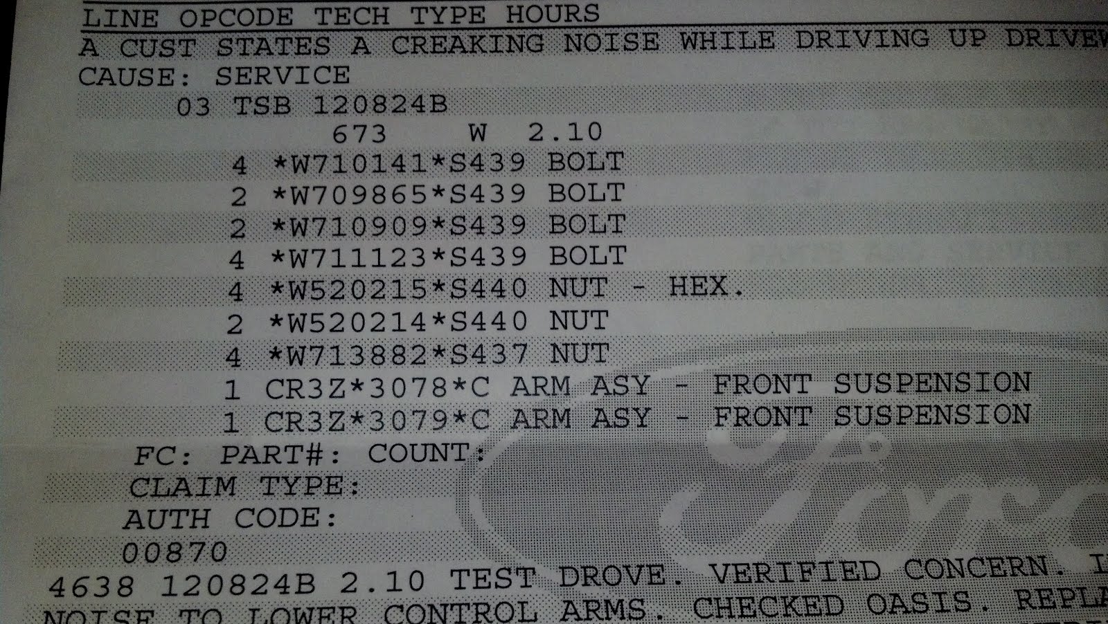

TSB # 12 08 24
just got my car back yesterday ... and loving it

Originally Posted by Shifterboy45
TSB # 12 08 24
Can't wait till I have time to get mine done. They are getting worse : (
