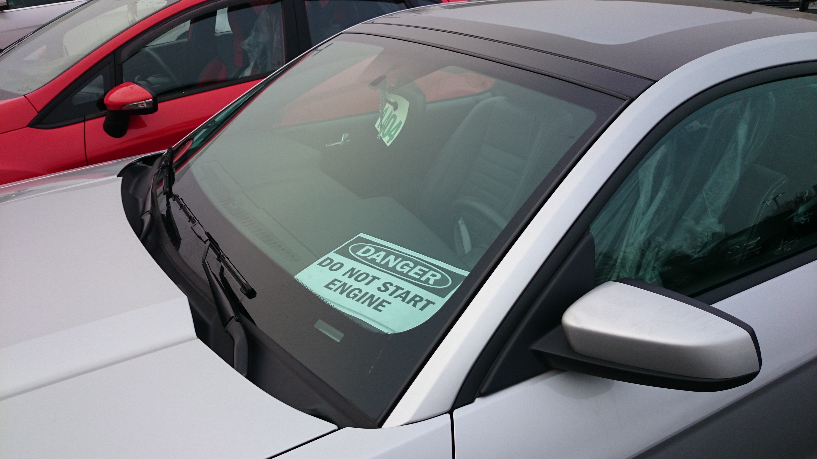

This is the situation I'm in right now. So my problem was in mornings, if I revved up to 2k rpm, I would hear rattling just under the hood, but it wouldn't happen under 2k rpm and it sounded like unlubricated valves tapping against pistons,but it would go away when engine got warm. My 5.0 has been in the shop since yesterday, upon my complaint dealership sent email to ford engineers which told them to take a look inside. So 2 techs working on it found out that cylinder no2 has a faulty "piston wrist" (apparently its a rod thats connected to the piston and crank shaft) that was causing the tapping. And my guess was that this particular cylinder is the reason for idle tapping too. Along with faulty cylinder no2, they're going to take apart the oil filter and check "bearings" in that cylinder. Its gonna be long time in the shop, he said they might even have to order new engine. we'll see.
UPDATE: the new short block arrived but I cant tell what percent the transfer is completed. Feel free to use my pictures for reference if it helps with your faulty coyote.. I can see they took out the flywheel and everything wow.
