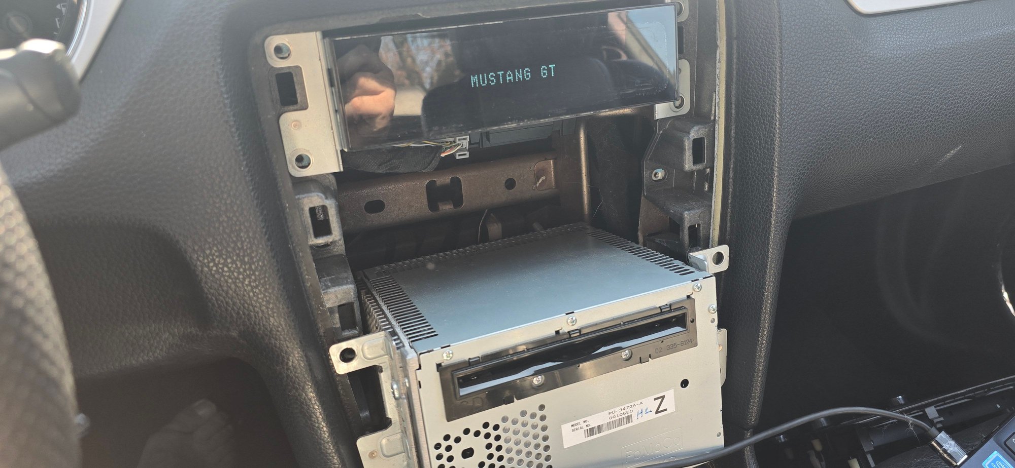

So, crazy enough. Im mapping canbus data...and I decided to pull the ACM from the car and see what signals are notably absent. Low and behold, look at where the FDIM defaults ...
