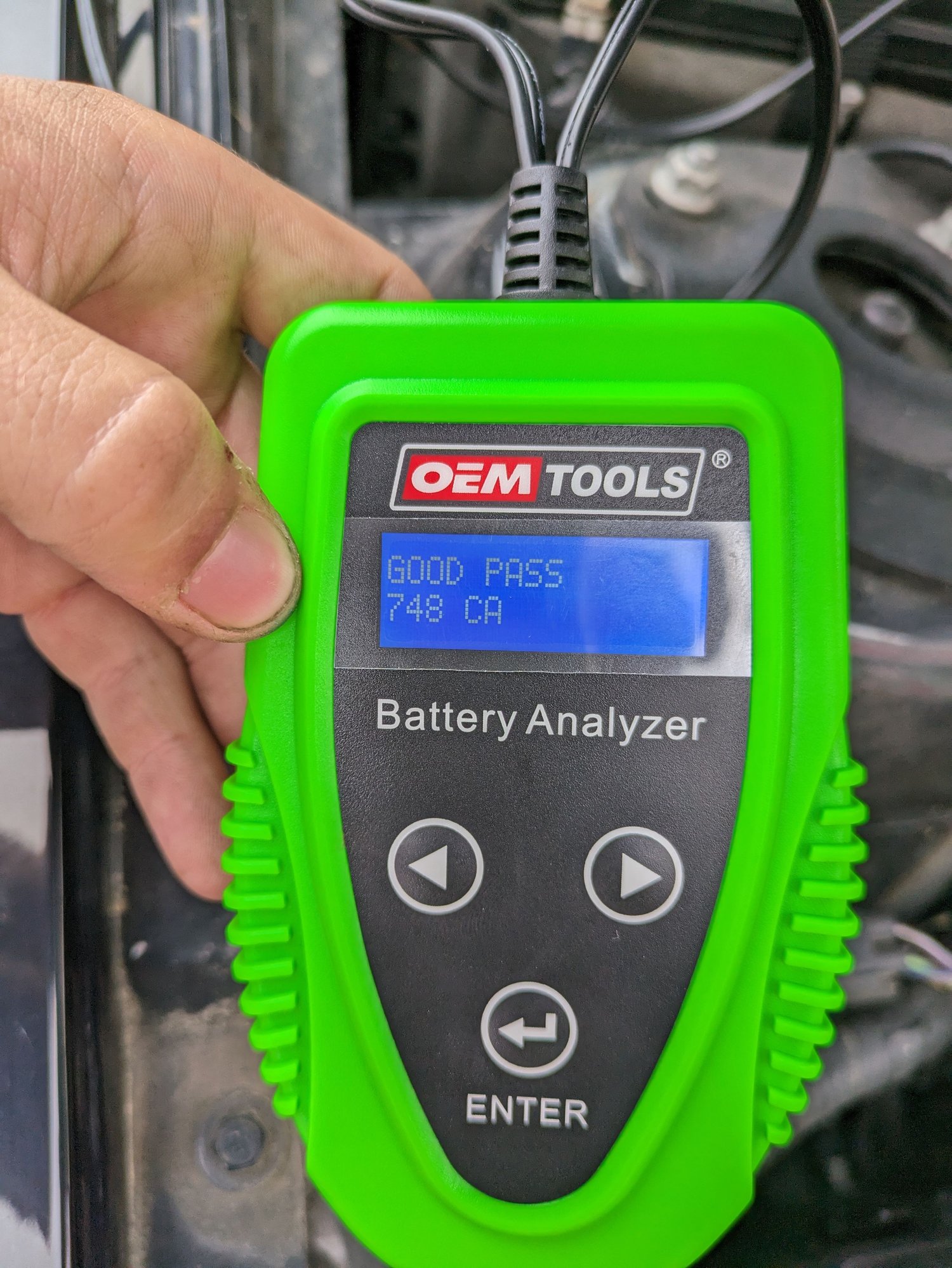

Battery tested as good by Autozone. Alternator I will have to remove for test as their advanced tester is broken. Not sure if this hand held paas is all that mineaningfull...
I'm going to try and get more items checked off the to do list this weekend.
Driven it past 2 days to work with no issues.
