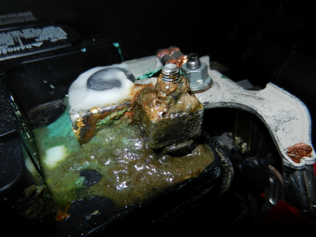

You can use Baking Soda, mixed with water to neutralize the acid and prevent damage to more of the engine bay. Be sure and check under the battery, and clean that area if you have not already done so. The baking soda will not damage the paint, but the coke could.
+1. I mix the baking soda and water into a soupy paste and use a toothbrush. Works wonders.
I also agree with Jim. Something has happened around the post for that to start suddenly, and it must be pretty bad. That is a massive amount of corrosion. A while back I had a battery develop a small crack in the top of the case that you could actually see, and even it wasn't corroding nearly that bad.

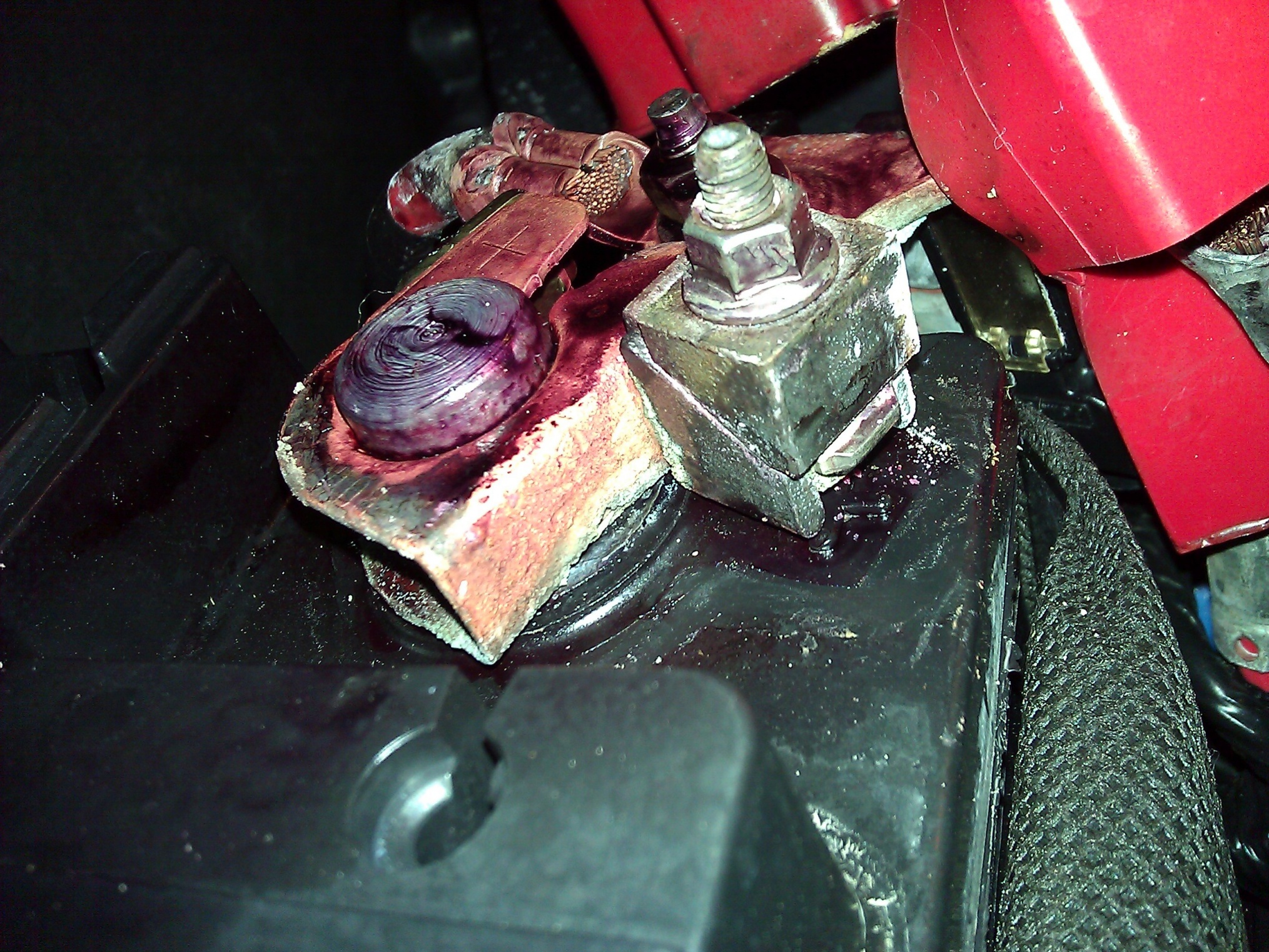

that pic is after three or four table spoons fell off. I first notice because I seen a pile of it in the garage.

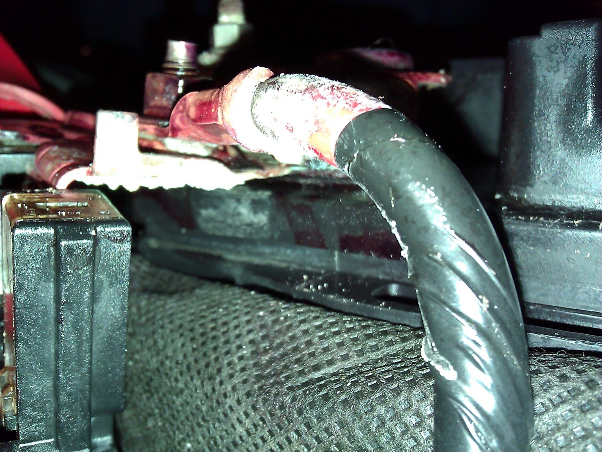

...I noticed a few days ago my battery is corroding like crazy on the positive pole... I show one of the service guys the problem and tell them it started after I had brought the car into the dealer for service last time...

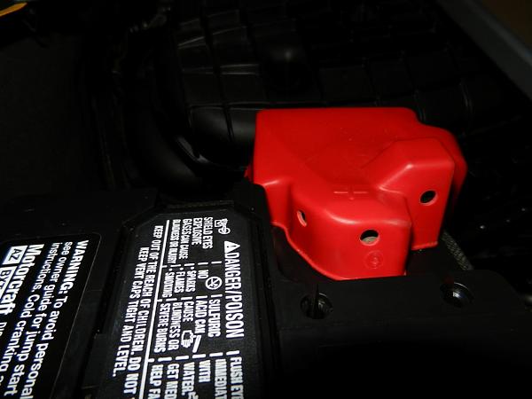

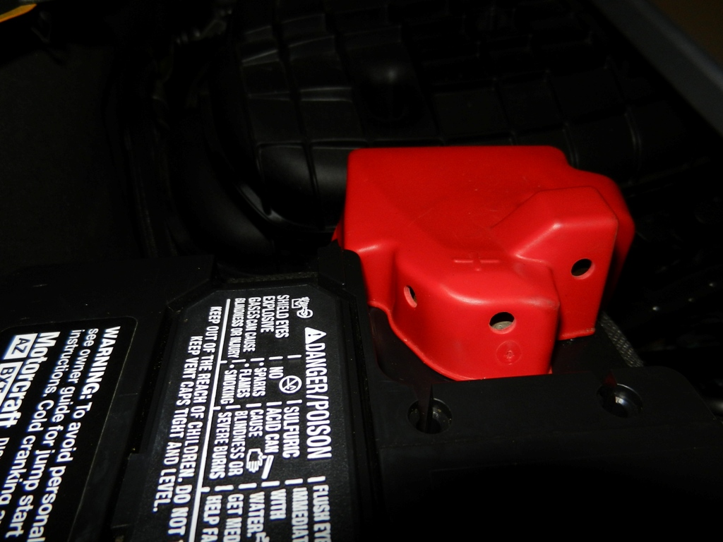

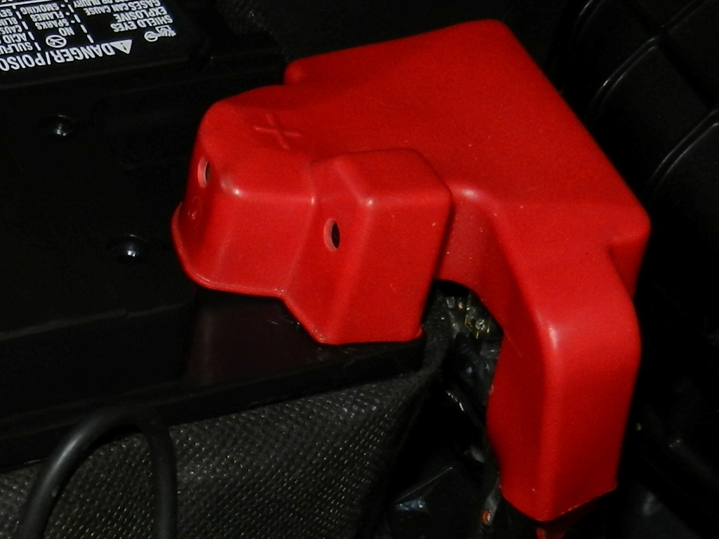

Well this certainly looks familiar! Your dealer likely added water to the battery when your car was serviced. I added distilled water to my battery @ 5,143 miles just prior to the one-year in-service anniversary. I then charged it overnight with my CTEK 3.3A charger. Less than 11 weeks later, I found the corrosion on the positive terminal @ 5,700 miles. The car is always clean, dry, garaged and used little. My theory is that the battery vented and the corrosive gas was trapped under the red battery insulator. The red insulator now sports several perforations and there has been no reoccurance after I cleaned up the mess and coated both terminals with dielectric compound. I would buy an AGM battery in a heartbeat if there were one correctly sized for this application.

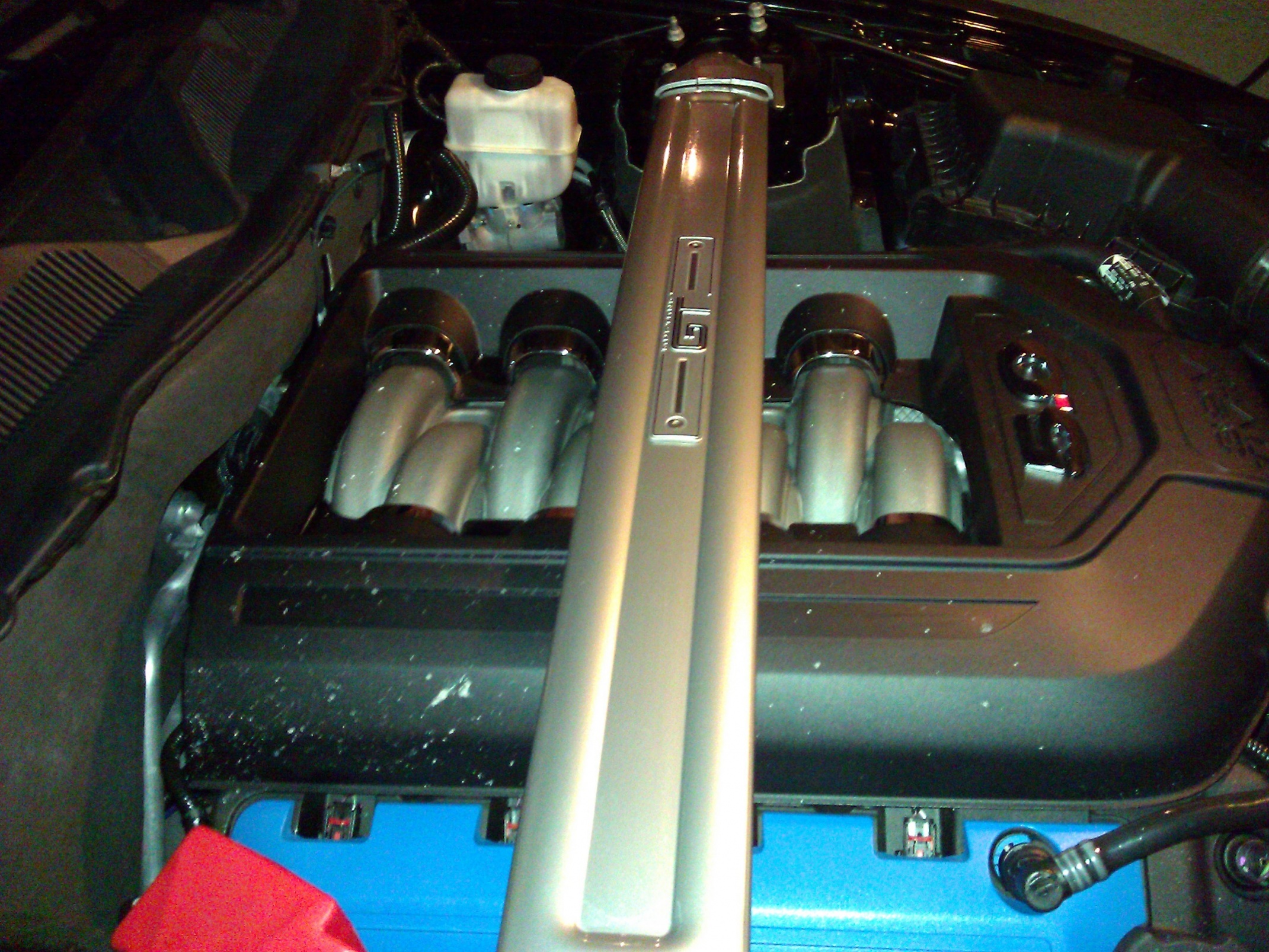

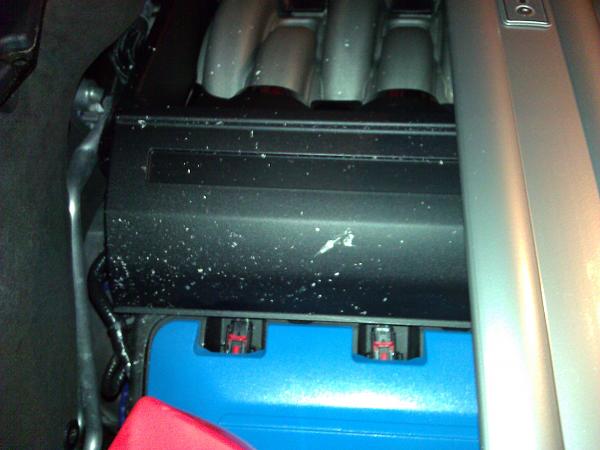

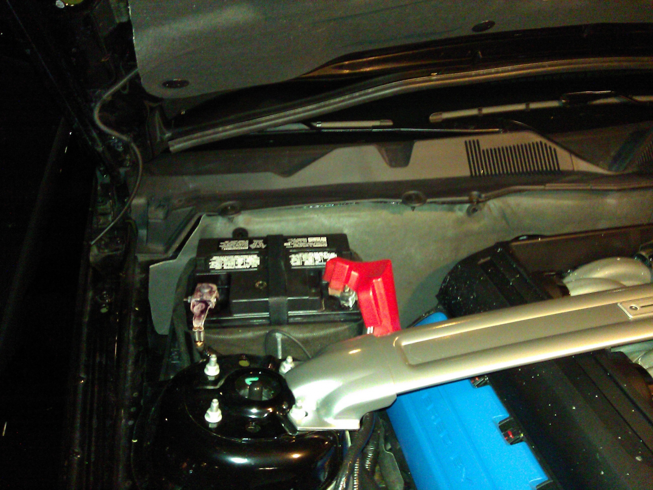

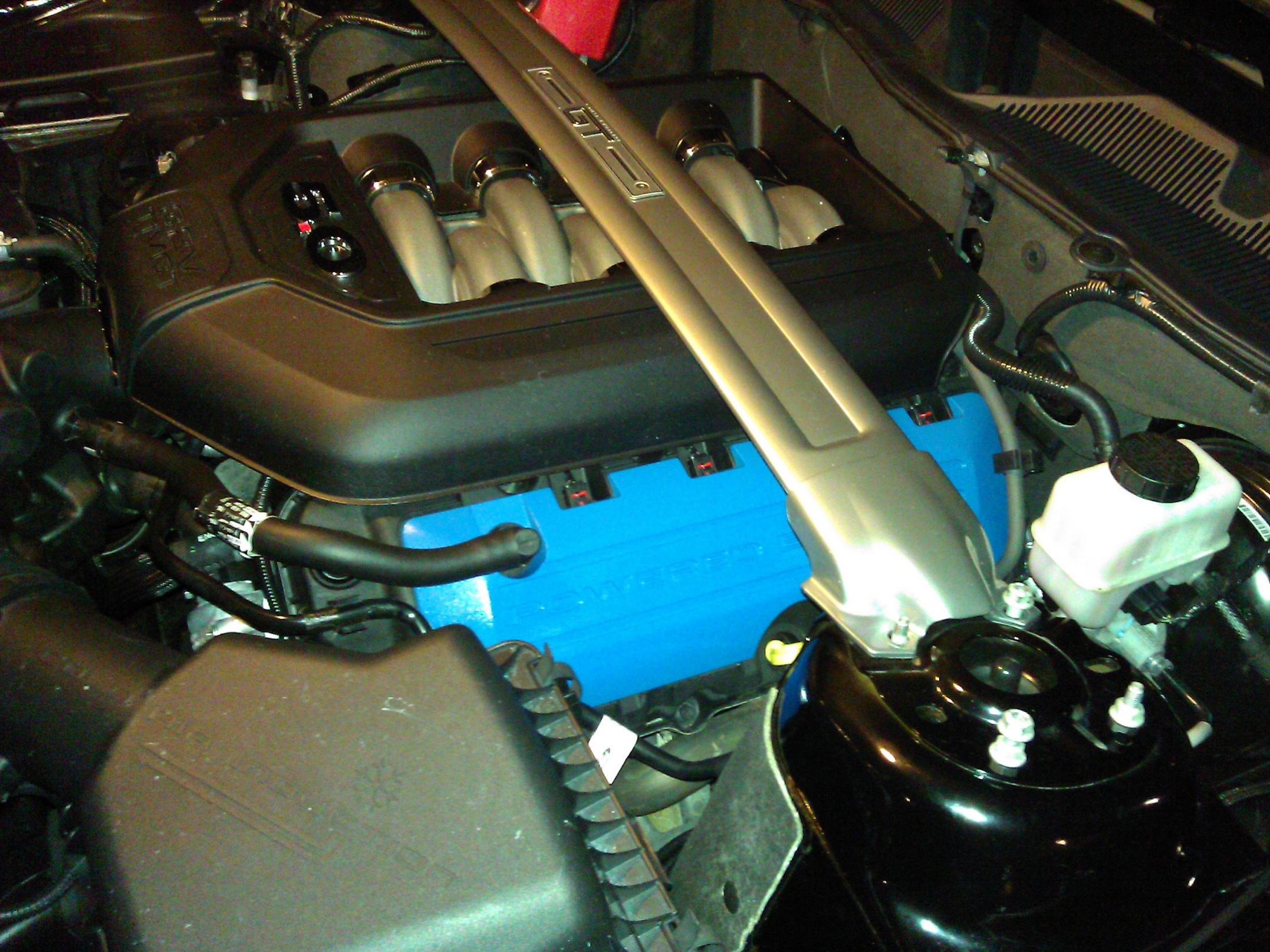

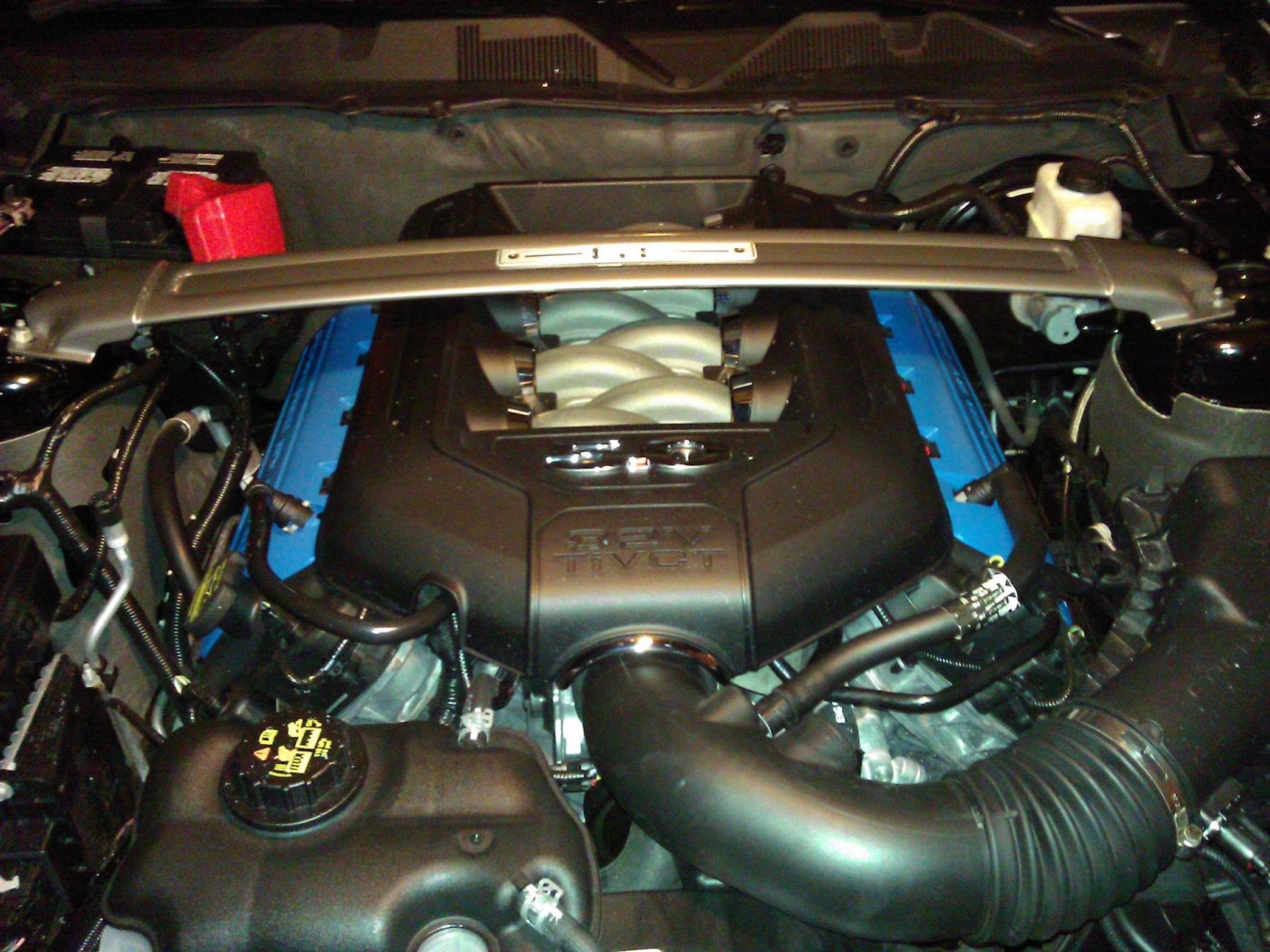

so I got the car back a few days ago from Bell Ford. The battery was cleaned up but they had white spots all under the hood from power washing the area. Before I left I got my service guy and the manager seen and followed us out. It looked like a tub of cool whip exploded on the battery side of the engine bay. The tech also came out that worked on the car and said "its hard water". I called BS and said if it was hard water it would be every where under the hood. They allied a purple protective gell on the post with the problem. They said they did not find a problem with the battery. They had about two or three square inchs of the purple stuff on my strut tower bar. The manage stepped in and said they would wash it again. He then stated they wanted me to be happy and they want to keep my business. I was told they had to order my part for the rattle and to come back in a few days when they get the part in.
Today I installed my rear deck speakers and reinstalled my "powered by ford" motor covers. I found that my back seat was covered in grease from the guy working on the rattle. I also found two of the plastic screws were missing. I also found all the white spots that were left on the upper motor cover would not come off when I was detailing the enigne bay.

Looks to me like you definitely have a leaking battery and as another member has mentioned, the gases are collecting under the red protective terminal cap. I wouldn't be surprised if the leak wasn't directly under the cap at the positive terminal. Perhaps a tech twisted around on the connection while trying to unhook the battery at some point and twisted hard enough to break the case around the positive post. To have that much corrosion, you must have a leak very nearby the terminal.
