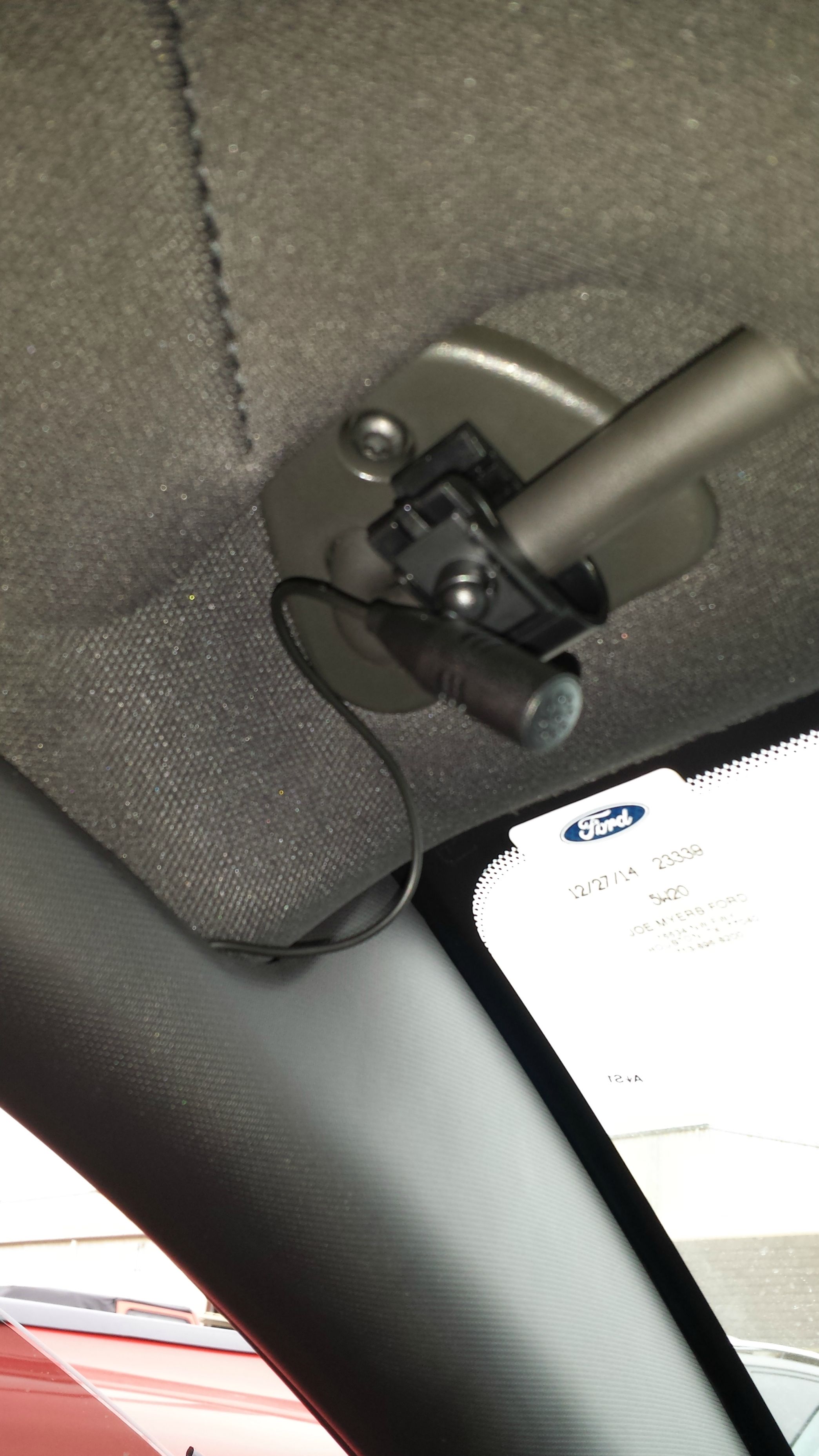

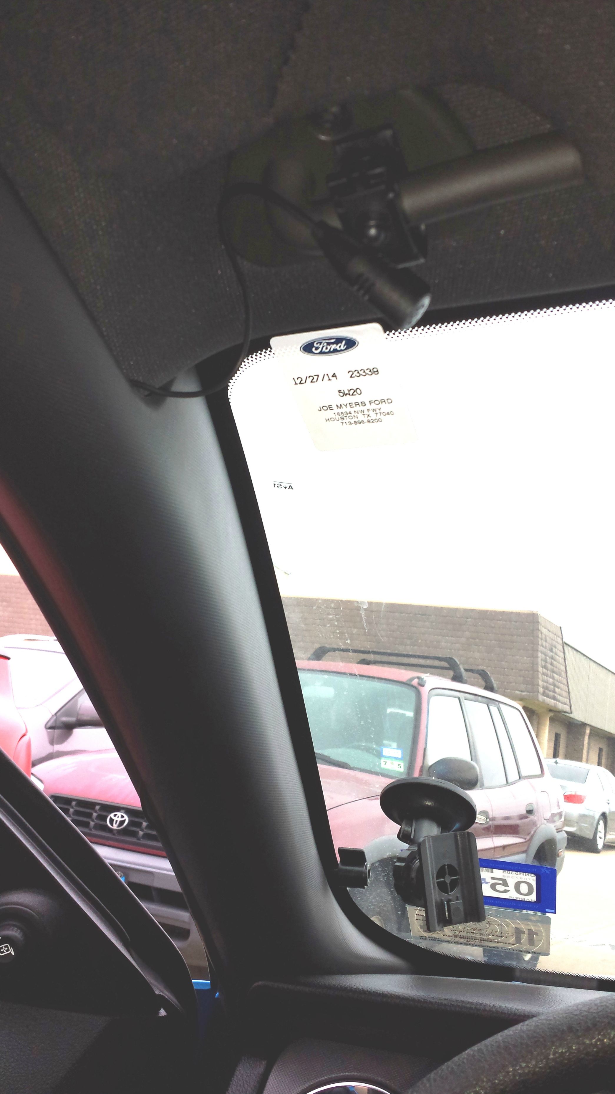

For the mic. I ran the wire behind the dash, , up the a pillar trim, to visor arm(mine came with a clip). I'll try and snag a pic later

Heres the pics. I apologize if its hard to see. Houston has been pretty gloomy lately.
Runs Behind the Apilar trim. (Edit: lightened the picture)

Clipped to the Visor bar
