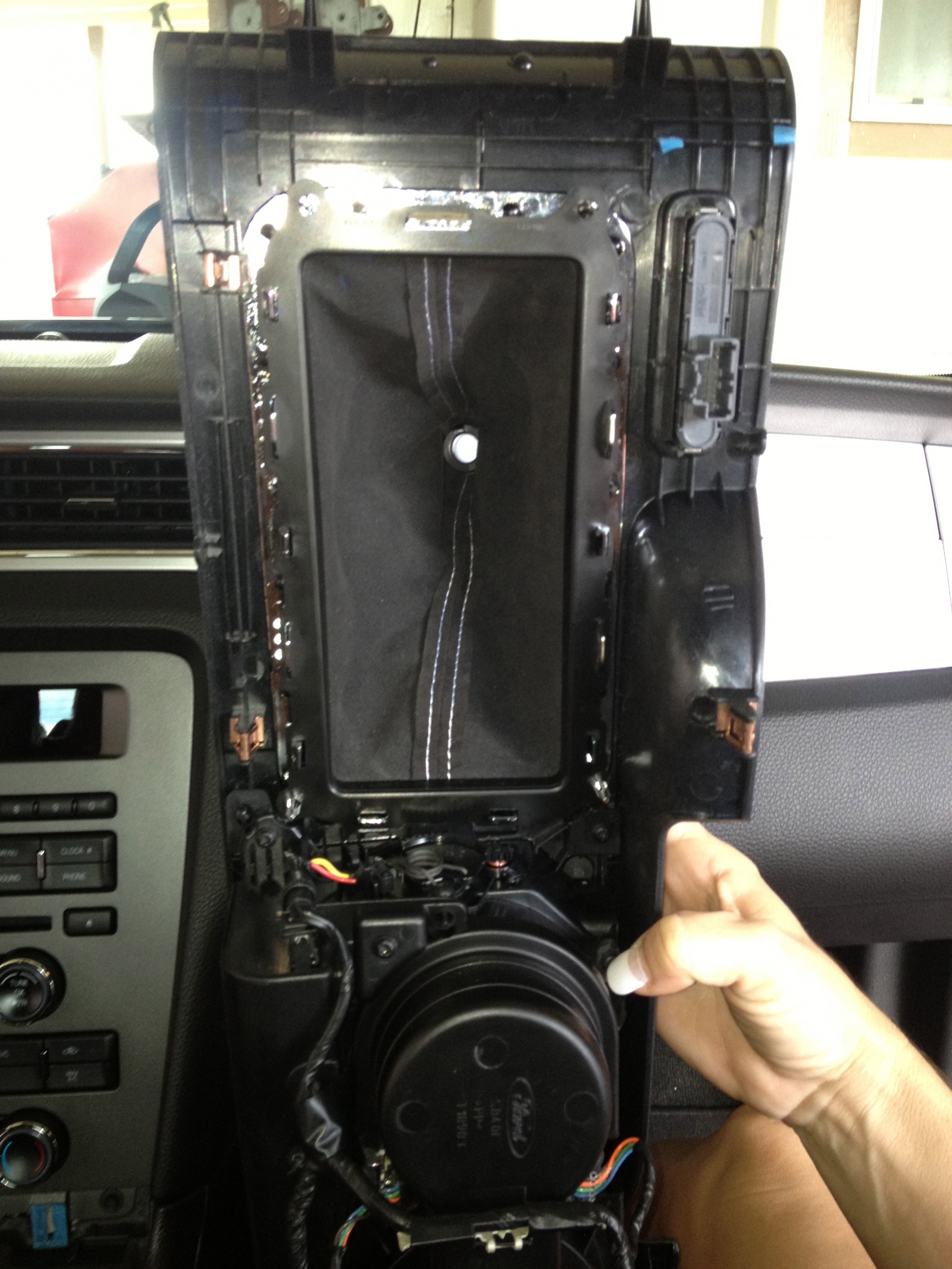

Here's the link to my thread where you can see what the boot looks like after you take the old one out. There are tabs all the way around the bottom of the console. The shift **** just twists off like you are unscrewing a bottle cap. Some of the tabs are tricky so use a 1/8" thick flat tip to get them off.

Thanks for your reply and not to be the biggest noob BUT how do I remove the console? I just looked all around and do not see a single screw. Mark

you kind of have to yank it up and off. start from the back half and get a firm grip and pull up.

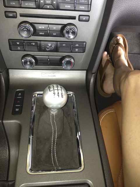

completed
Thanks, Here's the completed project.
