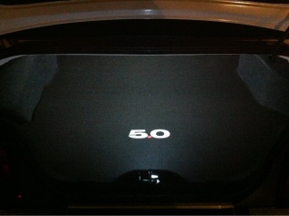

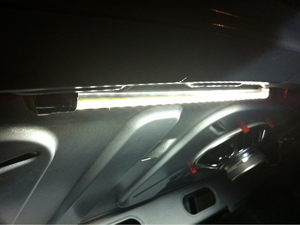

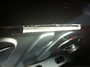

Got tired of the poor trunk lighting, and how a few bags blocked the light and made the trunk a dark abyss of black. So today, I Added some better lighting to the trunk today.
Changed the trunk bulb to LED, and added a superbrightLEDS 12in strip of LEDs to the bottom of the rear deck lid to light up the part of the trunk closest to the back seats.
Its now sooo much better, and I can actually see my whole trunk at night. Not to mention it matches my interior and license plate LED conversions.
Here's a few pics. They don't really do it justice of how bright it actually is. My iPhone fails to capture that.

When we did mine we removed the light and soldered the wires onto it and then just ran them in behind the plastic and carpet to hide them. took about 20 minutes.

I bought them from SuperBrightLEDs.
http://www.superbrightleds.com/cgi-b...D_LED_tube.htm
I used the 12in version. It's a 12v strip, so I just tapped it into the existing trunk circuit and switched the trunk bulb to LED so it matched the tube. Works amazingly.

Used the wires going to the stock trunk bulb. It's in the rear section of the trunk liners.
I stripped some insulation and used a bit of soder and some electrical tape.
