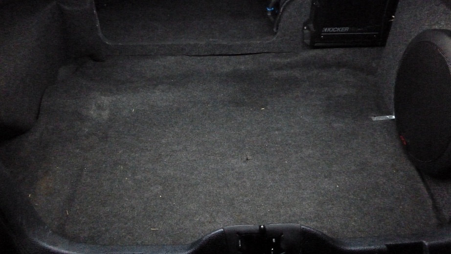

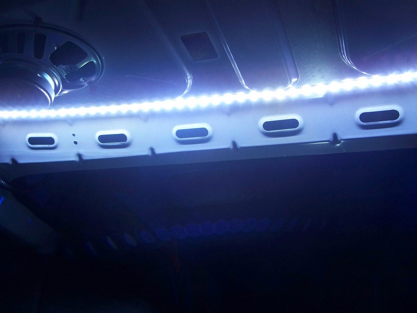

Completed this mod this week! Bought a string of 24 White LED's off Ebay. Very simple wiring. Simply a positive and a negative wire. Took the trunk light plug and cut it. Used my multimeter to determine which wire was the 12v and attached a male blade type connector to it. Did the same to the ground and then re-routed the wires around to the area under the rear decklid. Had to add a little wire to make it reach. Then crimped the female blade connectors to the wires on the LED string and plugged it in. The LED string came with some 3M adhesive backing and has been holding the past few days with no issues. Its been raining and humid here. We will see the first time it gets very cold. And even if the adhesive doesn't hold some real 3M double sided tape will do just nicely.

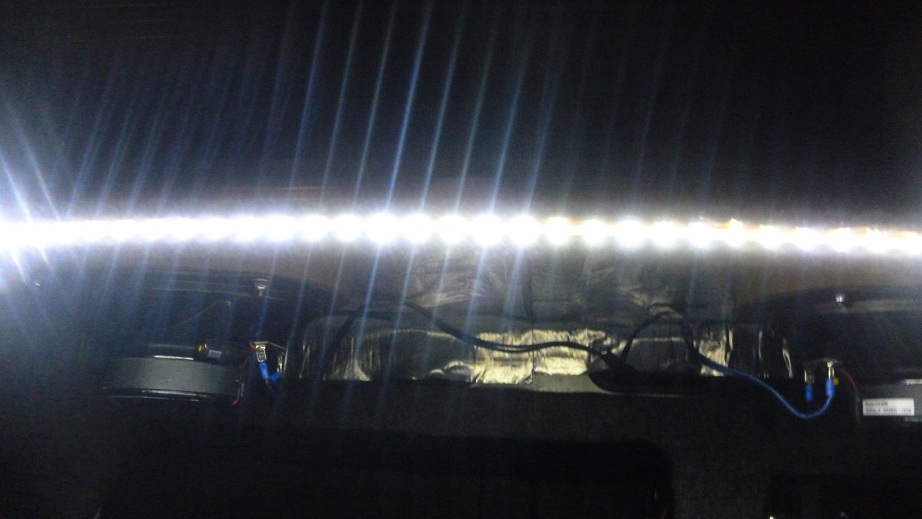

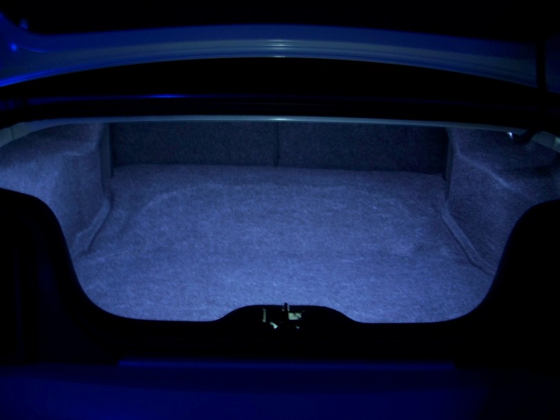

I finally got around to putting in the LED trunk light. A white 36" LED strip fits perfectly along the underside of the rear deck. Now there is plenty of light! And of course it operates tied in to the existing trunk light harness.
