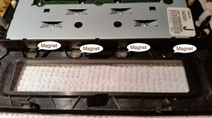

1) remove radio center console
2) locate 4 spots to mount magnets on back of center console ( there are already 4 circles in the plastic below the opening for the LED display)
3) clean the four spots with alcohol and wipe dry.
4) mix small amount of epoxy ( mix 20 seconds)
5) place epoxy on 4 spots on center console
6) place magnets on epoxy and press into place (magnets may want to jump to metal on radio head, put 4 more magnets on front to hold into place.) - ***it is very important to place magnets in such a way that the polarity of all 4 magnets are the same. (see pics)

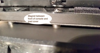

8) place ipad mini mount in desired location and secure with 4 more magnets.

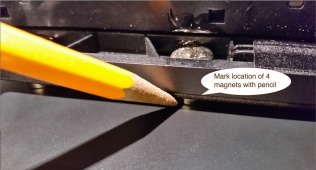

9) turn center console assembly over and place face down to mark the location of magnets
10) mark rear of ipad mini case with pencil.

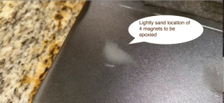

11) remove the case and sand the location for the magnets with some 220 sandpaper.

you won't see anything on the console once you remove the outside magnets. road tested this morning. great for normal driving.
