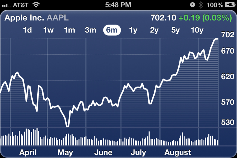

Originally Posted by mac951
Apple is so overrated!
- Sent from my iPhone
Have you checked the stock price? Lol
