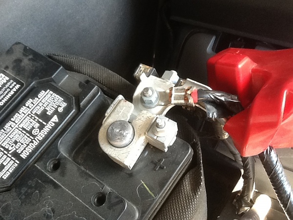

First I need to know if I installed the battery cable from battery to powered sub in the right spot. There are 3 bolts with wires already connected to the battery so I just undid the top bolt and added the cable on top of the one already there. Is that the correct spot?

There is a pic of the battery connector in my album photos sense I can't seem to post it. It shows the top bolt I'm talking about and the wires connected to it but I removed the sub power cable from it till I know if its the correct spot

The red rubber protector is battery "+" (positive), the other is ground. Not sure what you mean by "powered sub"; is this a sub woofer you are refering to? I can't believe it's drawing too much power from the battery to shut it down. Did you install a fuse between this connection of the battery to the powered sub? Is this wre getting warm or hot?
Posting the picture for you:

Thanks for the pic. Dead center in pic is where I installed it, right over top of the other wires that trail off to the right.
Yes a powered subwoofer and there is a 25 watt fuse a foot into the line on the power cord from the battery. Nothin really felt hot.
