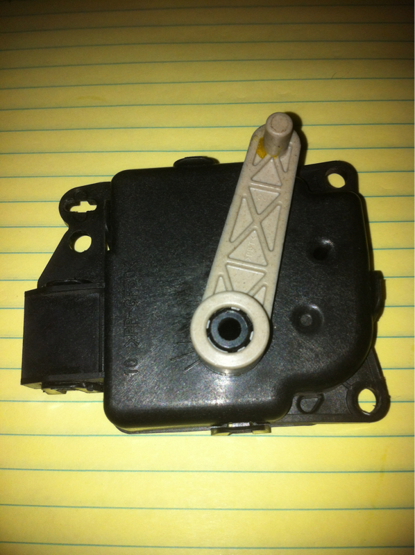

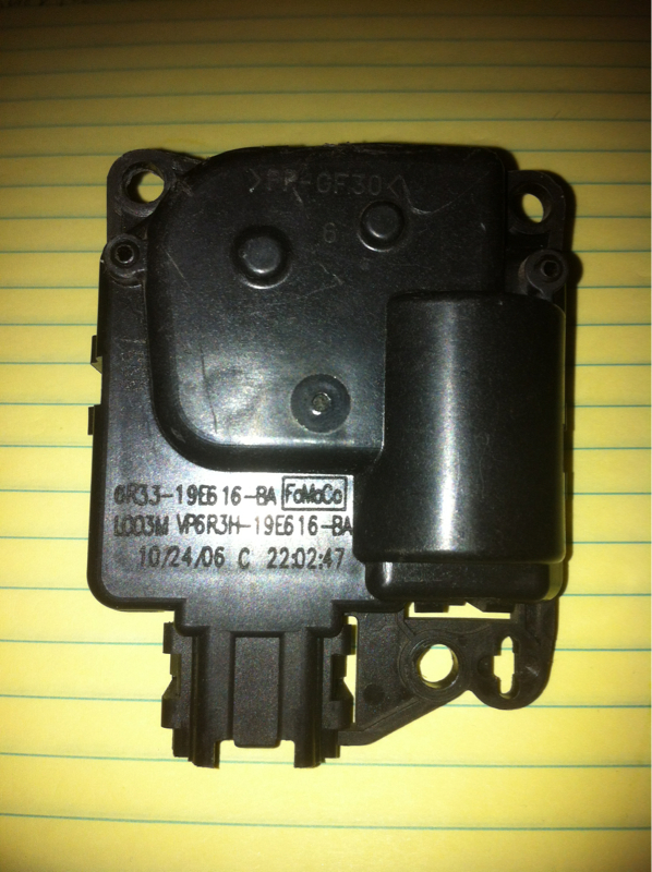

I had the very same problem when I turn on the AC. For now all I did was removed the HVAC Blend Actuator. From under the dashboard, I was able to remove one screw of the actuator. Than I had to remove the dashboard to get to the second screw of the actuator. (just for a moment of silence lol).... No more click..click..click...will purchase the replacement part later.
