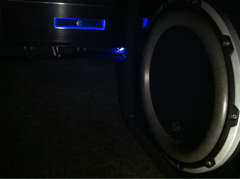

I have a Memphis audio 5 channel amp audio powering 1 JL Audio 12w6 with JL audio speakers with factory radio and i disconnected the door subs. Now it sounds really clean.

Here's a pic
That's a good looking install, thanks for the advice! I'm between going with one or two 12"s right now, how much power are you running to that one 12"?
