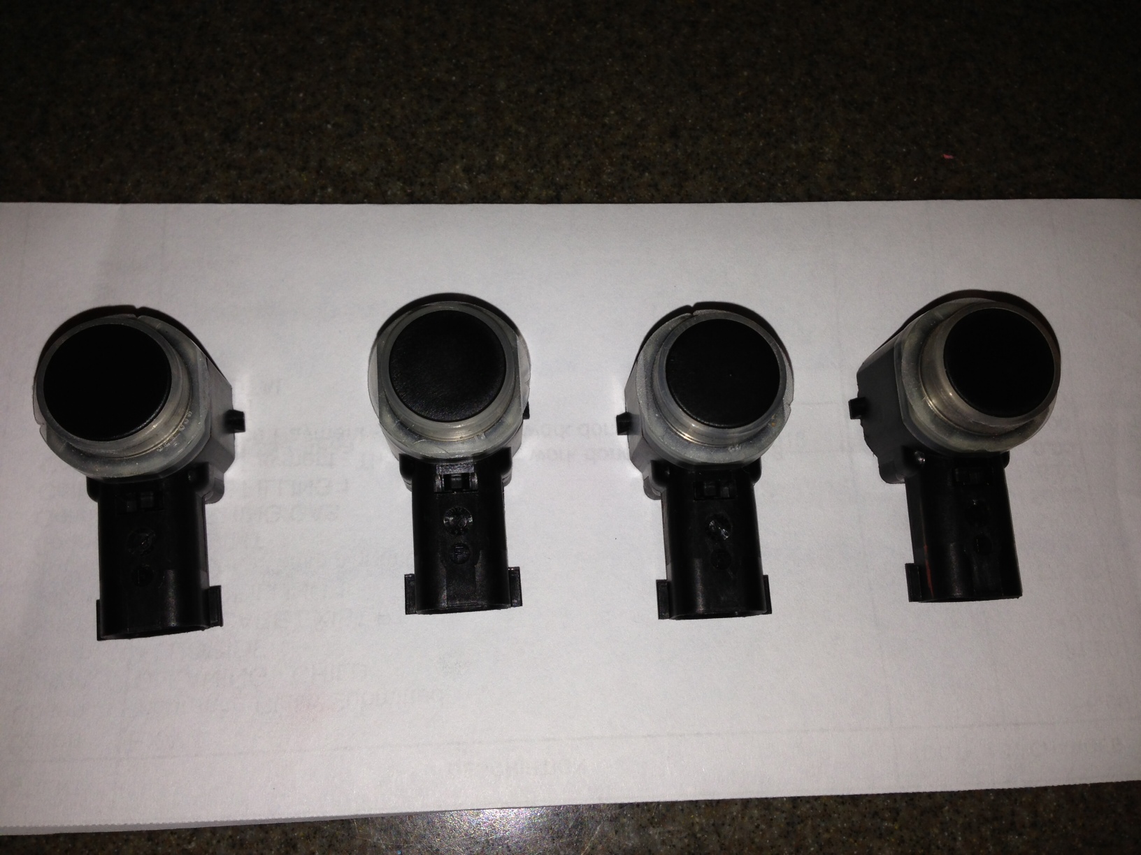

Got my eBay Sensors today ... painted them satin black to match rear valance. Rest of parts have been ordered and I should have them this week.

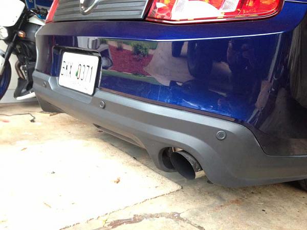

Success!! ... all the parts arrived today. ... drilled the bumper, installed the sensors, module and speakers. Works perfect. Cool thing is the 2012 Rear valance was already marked on the back side where to drill the holes so made things simple. I was worried at first since the instructions with the sensor module said programming was required. Said to copy the data from the original module to the new module. But I plugged it in and no programming needed.

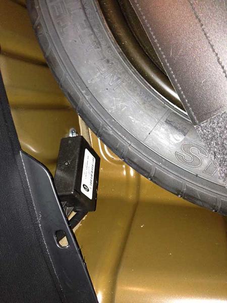

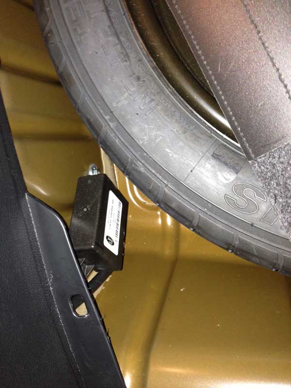

Here is install pic ... the module goes in spare tire well in existing empty plug ... the studs should already be there. The Speaker goes behind the driver kick panel .. empty plug should already be there too.
