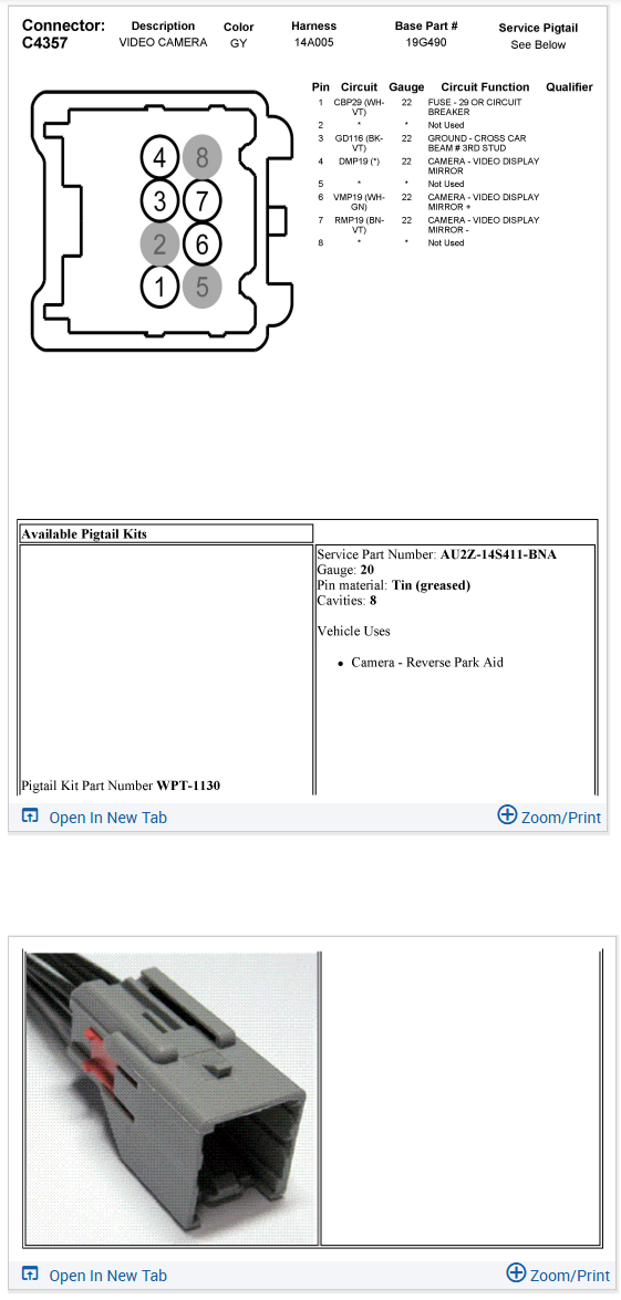

From: Medford, OR
Things kind of slowed down for a while with the covid virus and such disrupting work. Money got kind of tight for a while. It is now time to continue the Navigation project on my 2013 Mustang GT Premium. I have almost everything I need. I missed one thing, I need to buy the video cable that goes from the ACM to the screen. The part number is AR3Z-10E929-A. I checked our three local Ford dealers and several online. The cable has been discontinued. Does anyone have any ideas on what to use in its place or maybe where I can find one? Thanks,

For those of you attempting this in the future, WPT-1130 is discontinued and is now WPT-1580. Hope this helps

Connector no longer available
3 years ago, I posted that WPT-1580 was the replacement connector for WPT-1130. That is no longer the case. Ford has discontinued that part as well. If you want it to look stock, you will have to get another set of at least 5 pin connectors, both male and female. The local dealership said "That's why we don't work on cars over 10 years old." And they do not put aftermarket parts on their cars. So much for taking your older Mustang to the dealership for repairs.

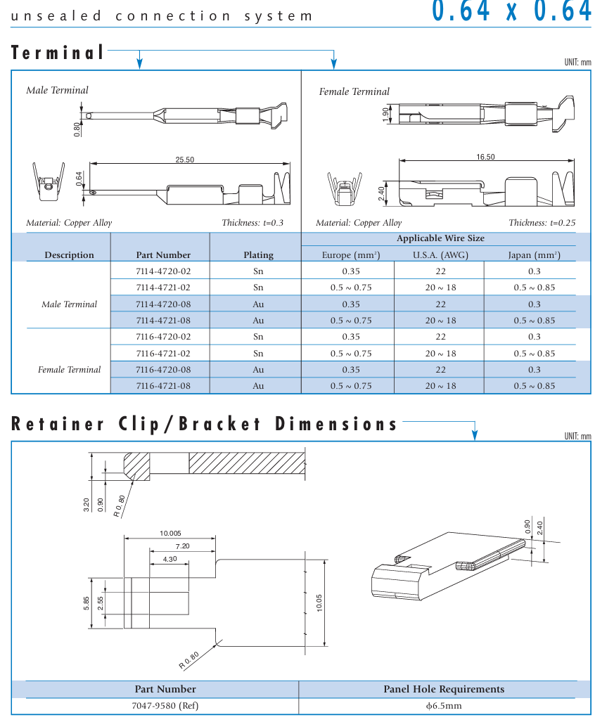

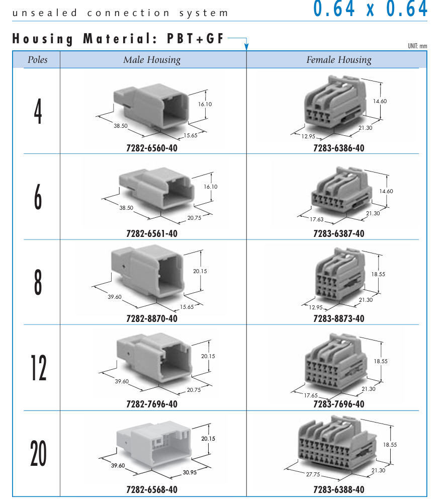

since we're all helping each other out.
It is a Yazaki connector:
YES/YESC Kaizen Connector 0.64X0.8 8P Male│YAZAKI Connectors Catalog
7282887040 Yazaki | Mouser
They can be bought here individually pinless for $16 here
7282-8870-40 YAZAKI CORP | 7282887040 | Quest Components
NOW YOU CAN MAKE YOUR OWN PIGTAIL!!!!

That is Some Good Digging. Well We See Where Ford Likely Gets Some of It's Connectors!
I Also Found The 2010-2012 Mustang Overhead Console Pigtail {May Differ At Console Depending on Vehicle Equipment.} To Be Close But Would Need Some Dremel/File Work on One or Both Plugs To Snap Together But it Looks Like Same Basic Design. Disregard The Drawn Pic, it is Way Off and Look at Actual Pigtail. Wpt-1184 Just Going By Pic For Interchange. I Would Surmise The Wiring Pins Would Be The Same.
Not a verified Interchange.
COMPARE Wpt-1184 TO Wpt-1130 on Second Pdf.
https://www.ebay.com/itm/164777295324
Btw This One on Ebay is DIRT CHEAP!
Compare To Normal Price!
https://www.fordpartsgiant.com/parts...3333;7286;7130)
