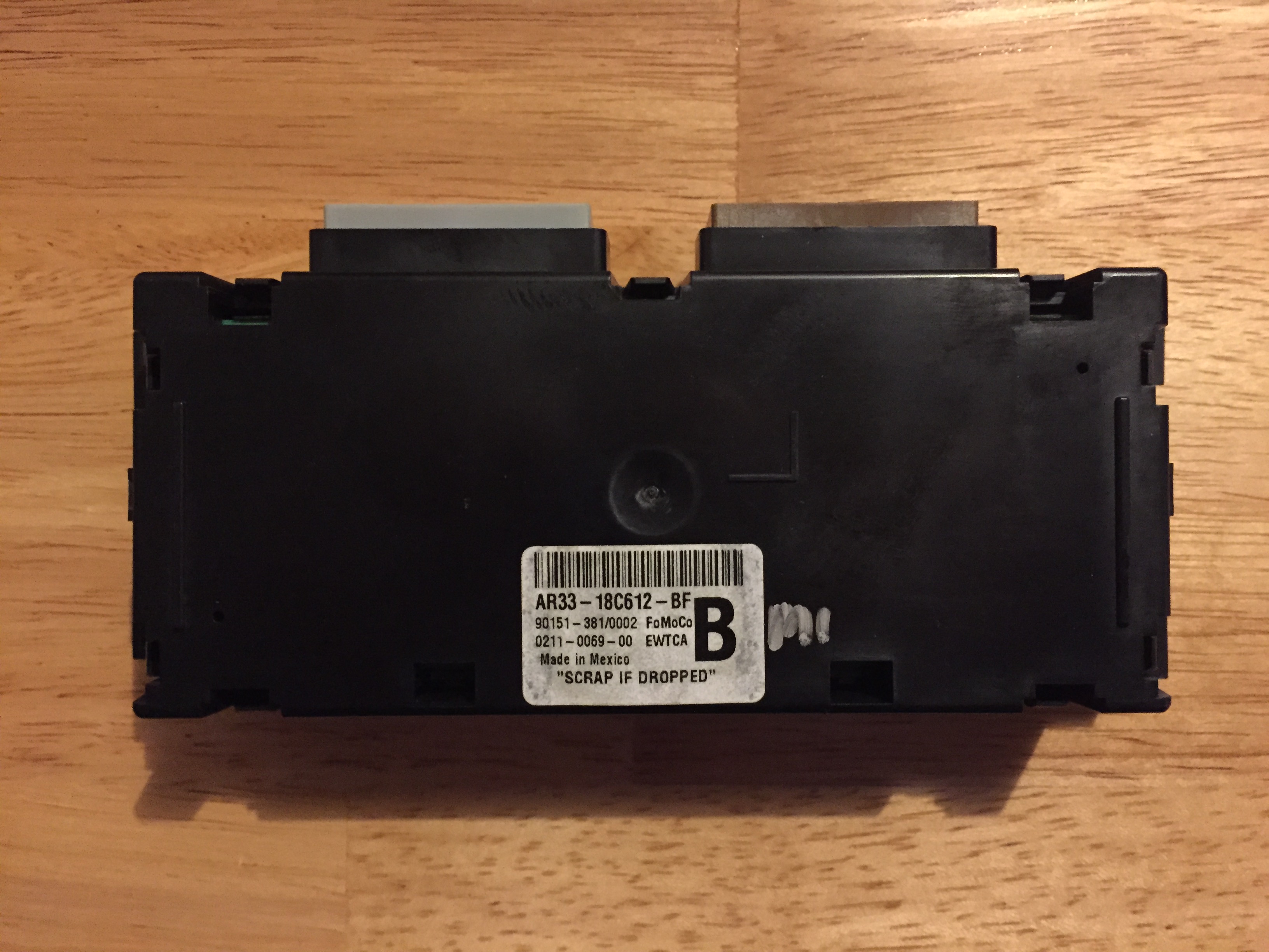

If have this one available for sale. If it fits, let me know, we can make a quick deal.

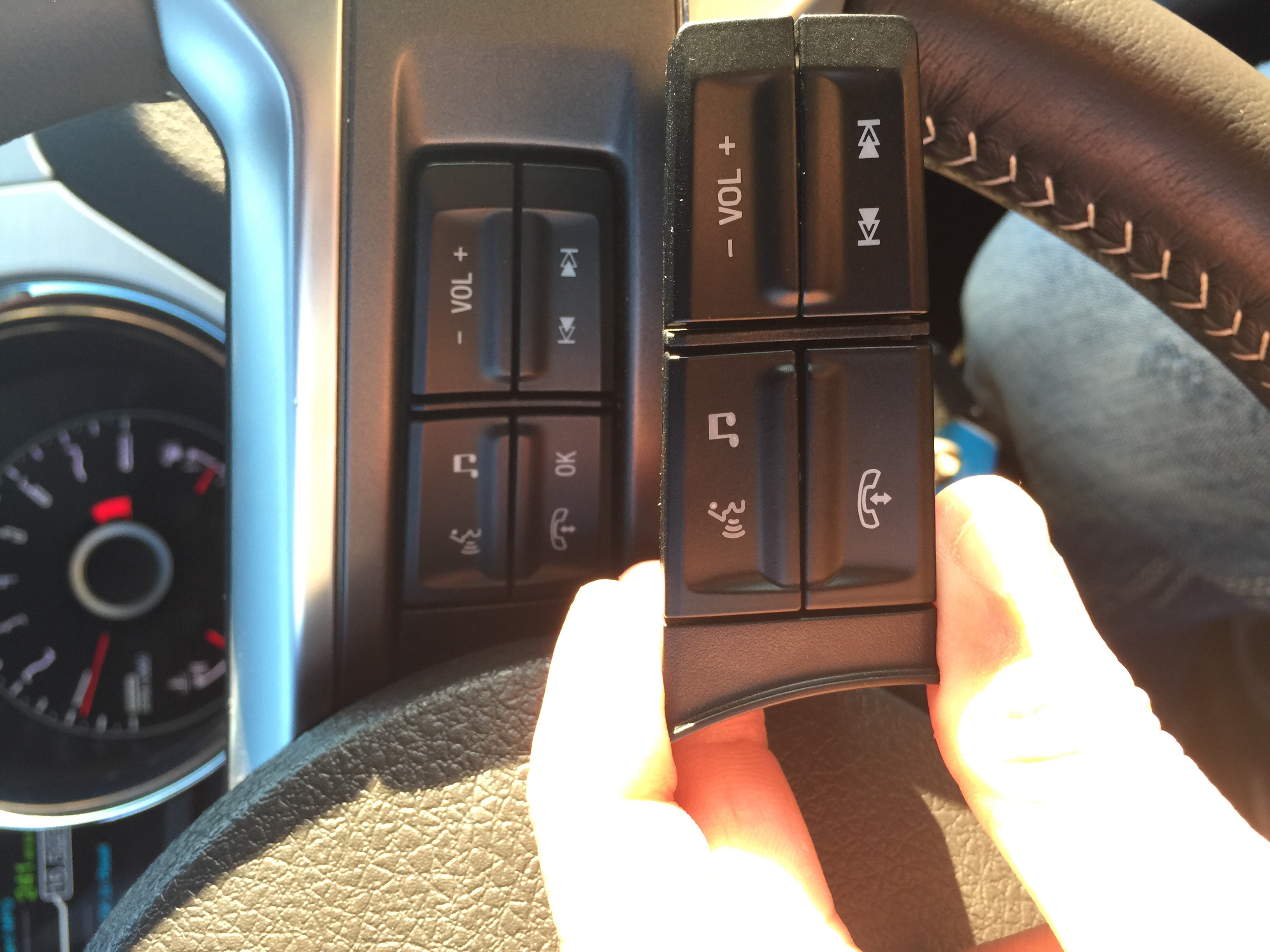

Odd question. I ordered the steering wheel controls (AR3Z9C888FA) and it doesn't have the "OK" button like my stock unit does. Is that to be expected????
