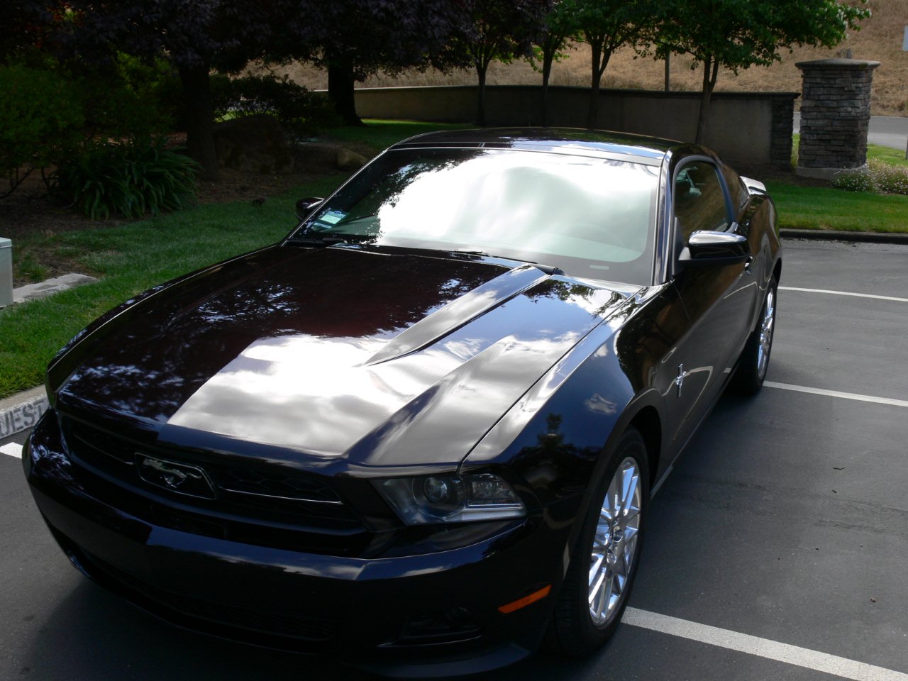

here is mine... you wash it and wax it just like you would the rest of the car... i even clay bared mine.. you cant even see it...
...until i purposely try to get a picture showing it

Xtc, how far up on the hood is yours?

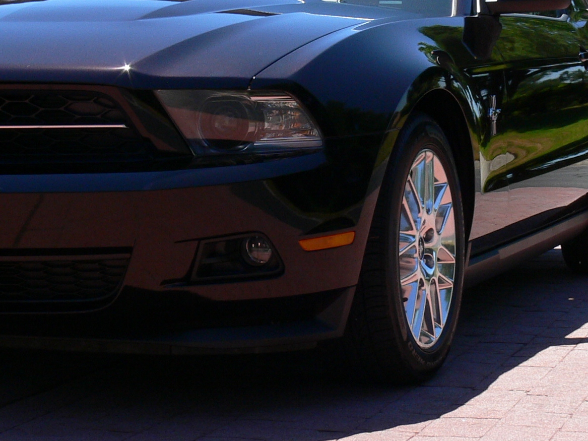

I'm sure this will work, yet I haven't found that to be necessary (too much labor for this body). As my installer told me, always spray, wipe, wash, apply wax, wipe off in the direction from the Clear Bra, towards the paint finish. Otherwise (over time), a build-up will occur along the interface edge where residue and wax gets forced into the seam.
For me, this has been the easiest - and has worked great so far.
Attached Thumbnails For those with the clear bra...-b.jpg   For those with the clear bra...-after-wax.jpg
