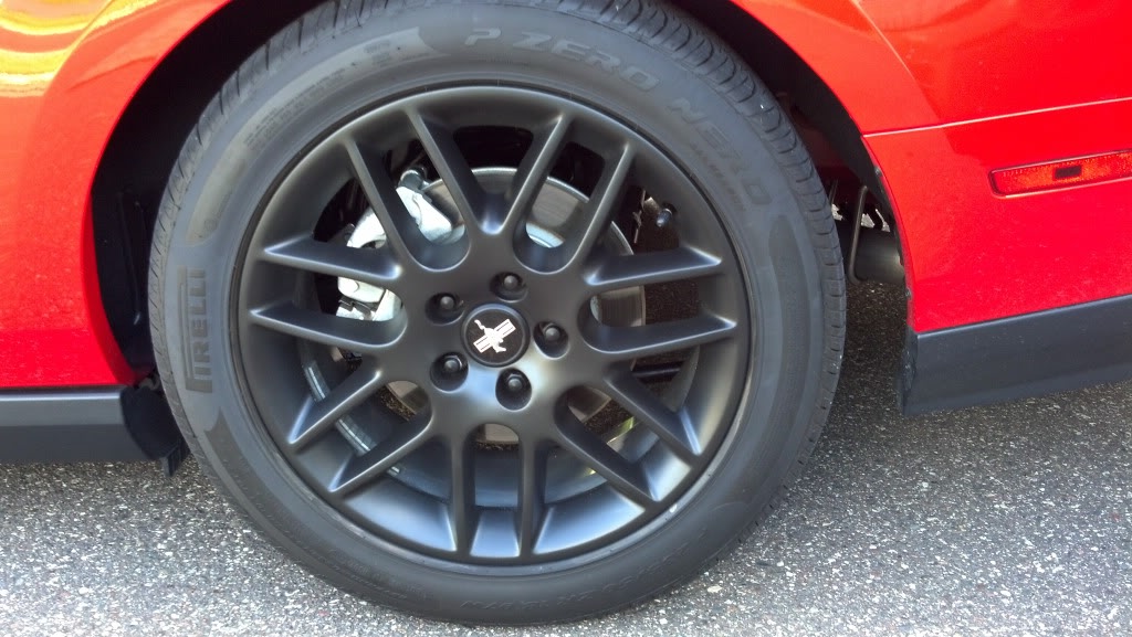

If done right it looks very nice and smooth, nothing like the rough, lumpy look of bed liner
Those came out nice. Not like the plasti dip stuff I see on cars around here.
Old Jul 16, 2012 | 07:56 AM
CCTking's Avatar
Joined: December 9, 2011
Posts: 3,584
From: Corpus Christi, TX
Well that is plasti dip on his rims. If you do the prep work right and take your time with the coats it can come out looking very nice. If not, then yea it ends up lookin like bed liner
I said the same thing as Matt. My faux cap came out bumpy. But damm your wheels came out awesome! What was your trick to getting it smooth and even like that??

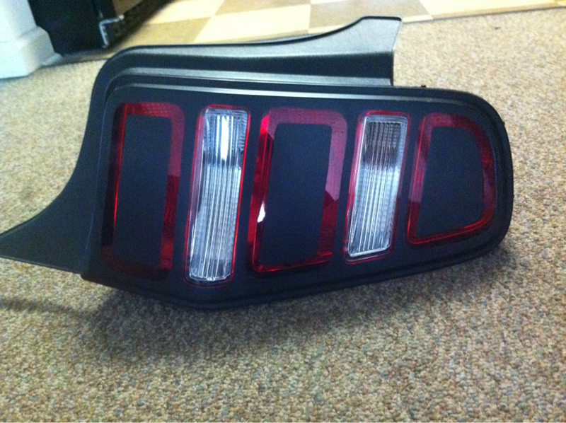

The biggest thing is keeping a good distance from the surface you're spraying. I found that 6"-8" from the surface works great. And keep a consistent speed going across.
This is all plasti-dip....
I think another thing is to get the coats on thick enough, if you go light with the coats it gets a rough look.
Take a piece if cardboard and practice, it shouldn't take long to get it down right
I did like 3 light coats, the first being super light. Then by the 4th and 5th I was getting so impatient I started really laying it on. Then when I took the tape off it peeled up in a few spots on the edges of the faux cap. I had it taped off right under the badge. I've seen people make a square around it??? Then I guess razor blade the edges? Help!!!
No...when you peel with the square, it does a clean line when it hits the separate surface of the cap. It's really cool watching.
The biggest thing is patience with this stuff. The thing I keep telling myself when I'm spraying, is "THIS IS SOO MUCH CHEAPER THAN DOING ANYTHING ELSE, MAJE IT COUNT!"
Practice, and it'll come out perfect every time. I'd it doesn't, figure out what you did wrong, peel up the mess, and spray again.
