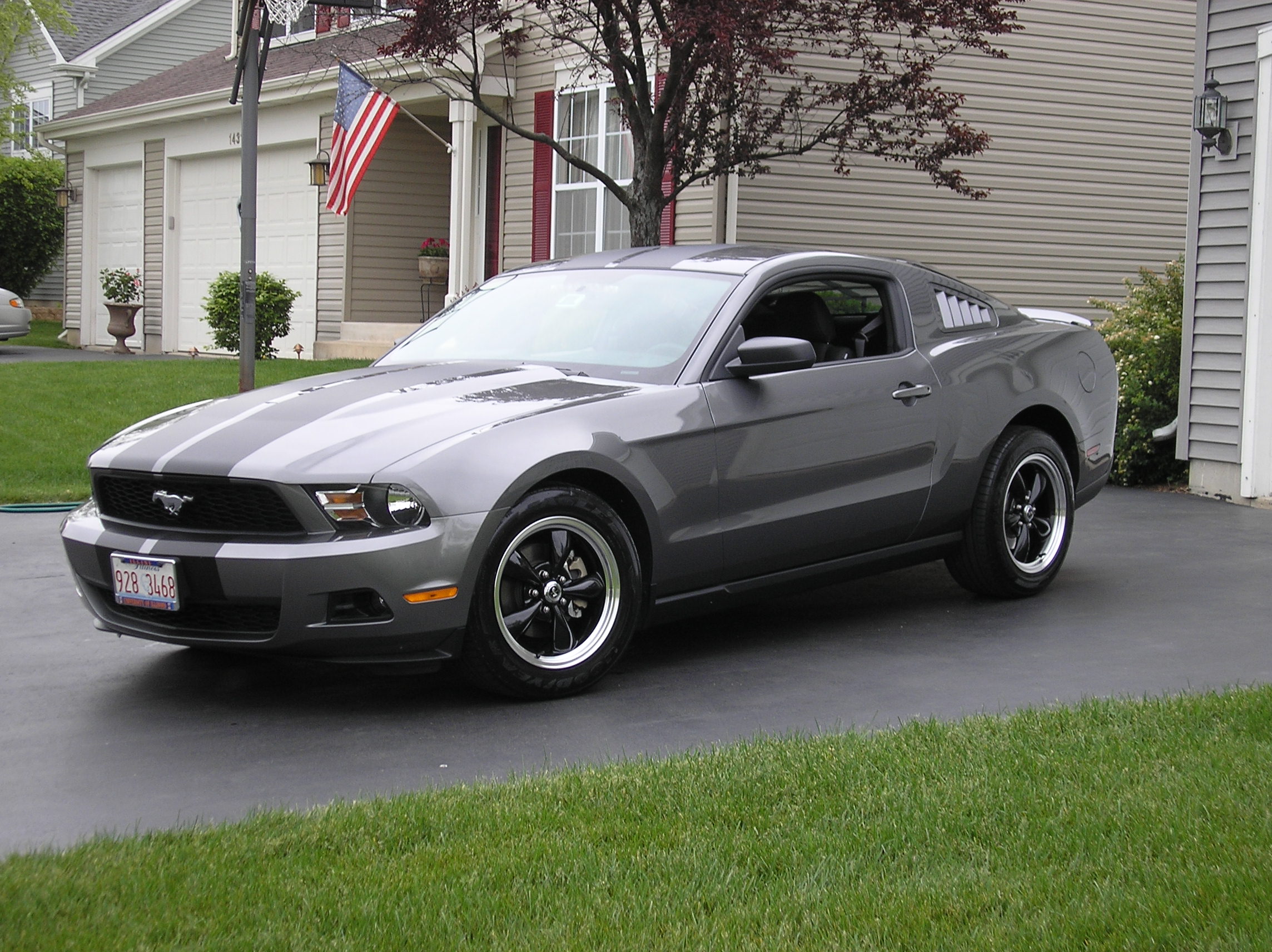

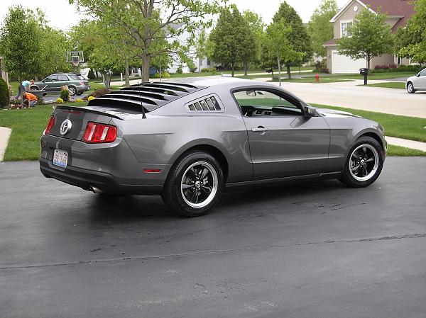

Thanks for the good advice. My local body shop would paint them on for $500. The RIGHT paint job is more like $1500. Difference is proper prep, clear coat, etc. And if I ever have problems (dents, rock chips, God forbid an accident), vinyl much easier to replace. So I went ahead and had vinyl done yesterday. Hope you all like the pics.
My stripe "guy" stated that a problem with the kits out there is not only quality of the vinyl, but also the age. Says they start to go bad after several months; vinyl striping has a shelf life. Not so sure I subscribe to that, but he's done awesome work and seems to know his stuff.
One last thing - you mention the stripes stain easily. I've got crap water where I live, and water stains a constant frustration when I wash the car (even with the best car wash soap that is supposed to repel spotting). Not sure I want to use anything even mildly aggressive to clean the vinyl (like diluted CLR). Suggestions?

That right there looks REALLY hot!
