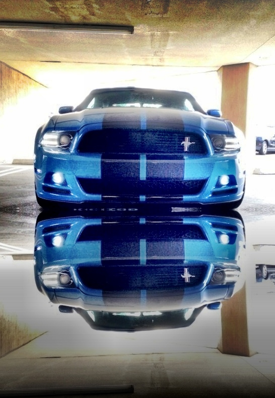

Here's mine with HIDs retrofitted in the fogs.
That looks freakin sweet
I got bored & played on some of my apps

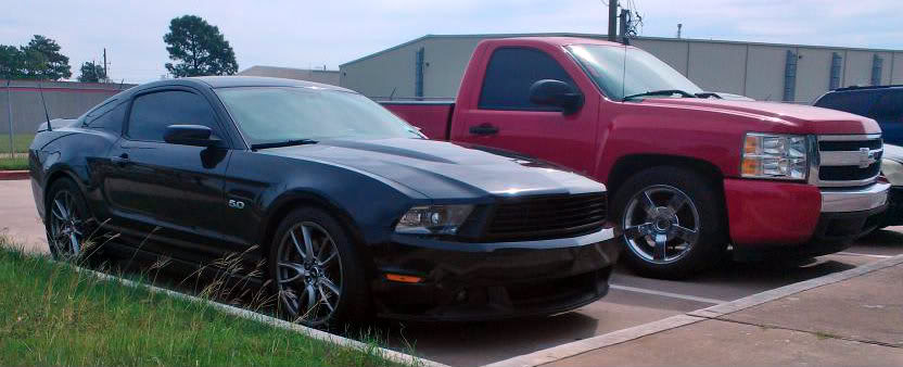

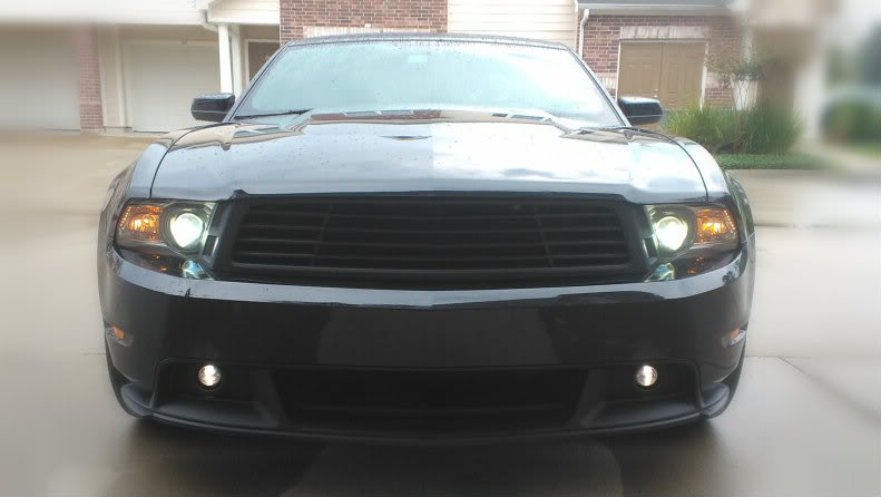

I finally got some new bulbs that are a closer match to the HID's. The only real way to match the HID's is to actually have HID's. But these are close enough for me.
I also changed my grille if you didn't notice
This is a pic I just snapped here at work sitting next to my buddies built 5.7 lsx with a procharger and nitrous
