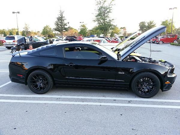

Fronts- 18x9 SVE, 275/40/18 NT05
Rear- 18x10 SVE, 295/35/18 NT05
These tires are GREAT! once you get em warm, they hook great. i love em.
