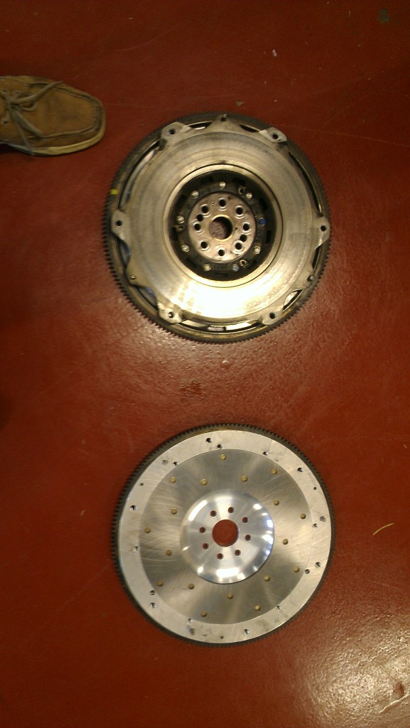

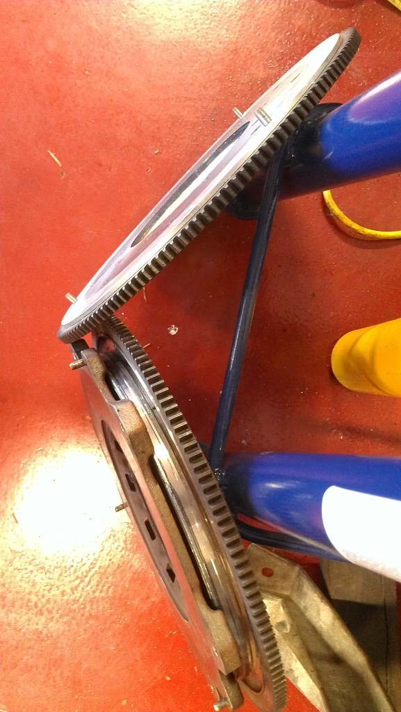

Alright so i finally got tired of the annoying decel vibrations and ive been having some problems shifting. so i decided to try replacing the clutch and flywheel. well im sure glad i decided to get it after seeing how massive the stock one is. being a dual mass flywheel its going to be heavy but i didnt realize just how heavy it would be. the ram one is around 3 times thinner than the stock one and is much much lighter. i have attached some pics so you can see the difference in the stock and the ram one. im currently not done with the install yet because i didnt realize i had to get new fly wheel to crank bolts since the stock ones are way to long for the new flywheel. i ended up having to drive 2 hours one way to pick them up. i bought them for a 04 cobra mustang, ram said thats what i need but ill find out tomorrow when i try them out. the transmission removal is extremely simple on these cars. within a hour and a half it was on the floor and the stock flywheel and clutch were off.
the first picture shows all the stock parts next to the new parts. the clutch im using is the spec stage 1 clutch.
the second picture is the stock flywheel on the bottom and the ram flywheel on the top. notice how much thicker the stock dual mass one is.
the third picture is the stock on top and ram on the bottom.
