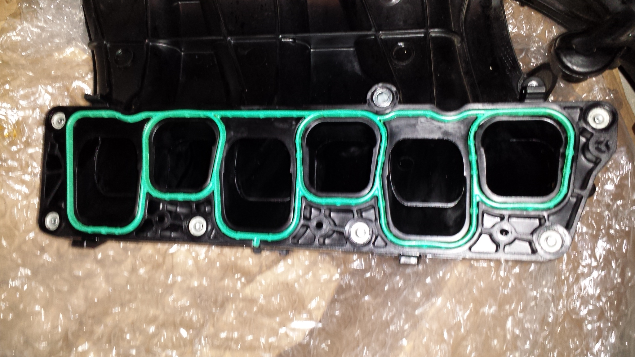

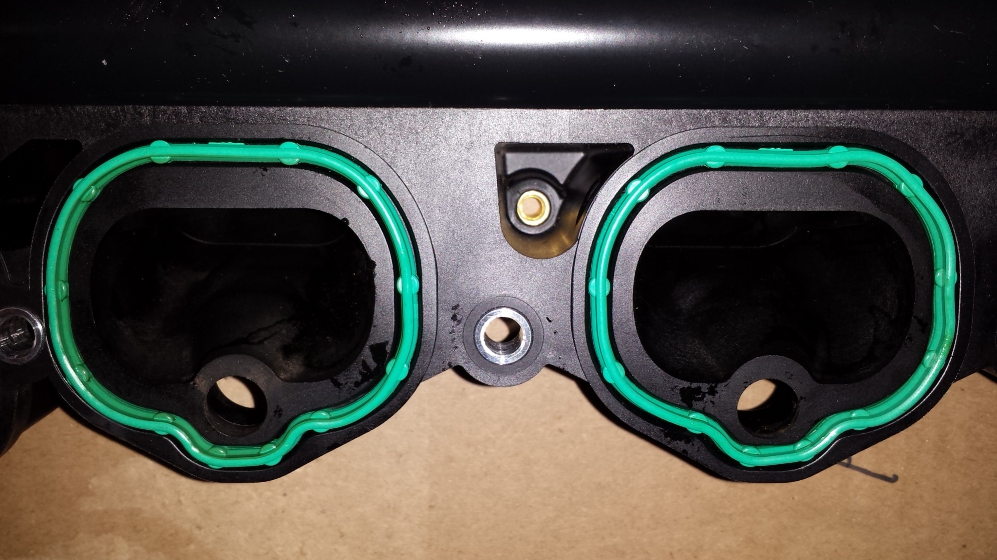

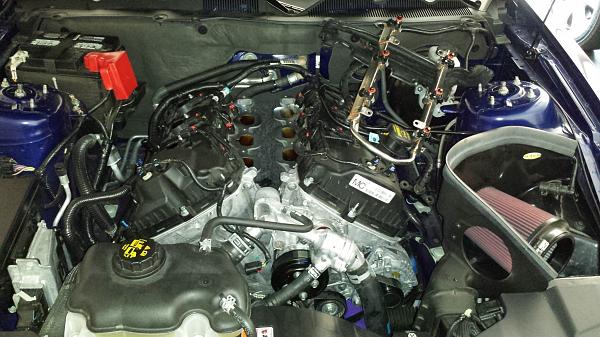

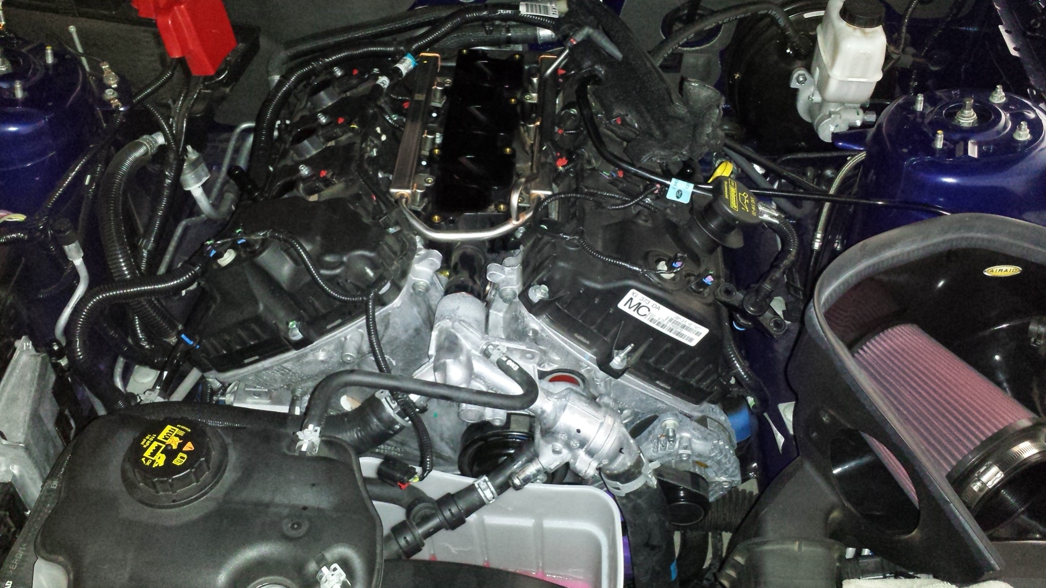

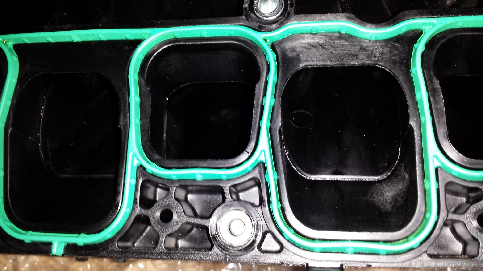

Hey all, thought I would share my experience with installing ported and polished upper and lower intake manifolds that I got from Tom @ Lone Wolf Performance. To start I did this by myself in my garage and had a blast doing it. This is a great mod for us 11-14 3.7 guys as there are currently no options to install aftermarket manifolds. I started by contacting Tom @ Lone Wolf on a recommendation from one of the members on here and he told me $365 to do the work and ship the parts to me. I thought this was great b/c the company I was going to go with charges $500 to do the same thing (Super Six Motorsports). Next I ordered some new upper and lower manifolds from Tousley for $200 and had them shipped directly to Tom to be ported. I did this because I didn't want to leave the top of the engine dismantled while I waited for the parts from my car to be ported so I bought new ones. Once Tom got the intakes it took him about 4 days to complete the work and then a couples days to get to me. Once I got them I installed them in about 4 hours on a Saturday. Very easy install using a "1/4 socket wrench and 8mm socket mostly. The video below was very helpful and shows everything. I took a few short cuts which helped a lot (Didn't drain the radiator instead I just took off the hose at the thermostat & I didn't completely dismantle the fuel injectors like it shows in the video). I just recently got my tune dailed in for the extra air flow and I couldn't be happier!! I haven't had it dynoed but I think it definitely picked up the advertised 15hp/15tq. Its mostly in the mid to upper range. Overall I recommend this mod to all v6 guys, especially those building a 3.7 sleeper!

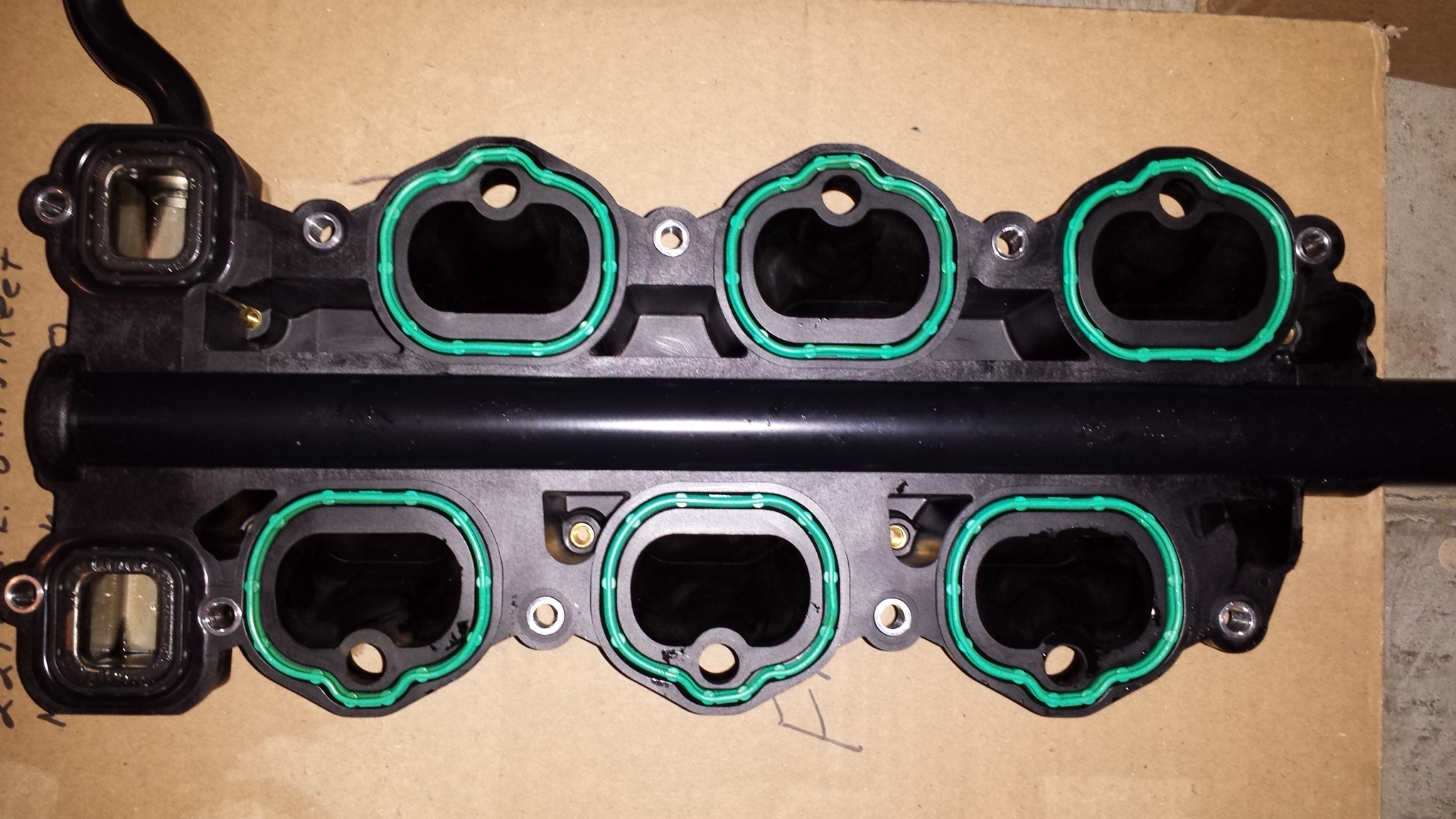

No worries, I will post up a pic of the unported ones when I get home but you will be hard pressed to see alot of difference sine the manifolds are black and it's hard to see a difference in pics or the videos I posted above but trust me there's a difference!

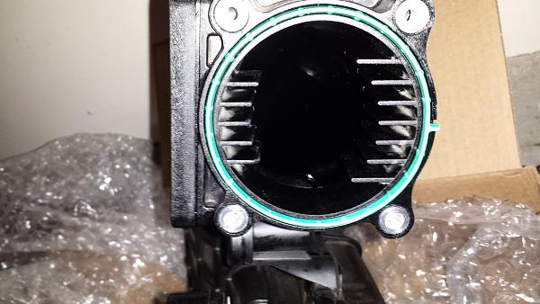

Ok sorry it took me so long but here are the pics of my unported intake manifolds. Like I was saying you can't tell as much difference through the photos. One of the main things I can tell you is that if you look at the photo of the upper intake where the throttle body mates up to it the fins you see are removed on the ported one.
Attached Thumbnails Ported & Polished Intake Manifolds-20140203_174752.jpg   Ported & Polished Intake Manifolds-20140203_174802.jpg   Ported & Polished Intake Manifolds-20140203_174808.jpg   Ported & Polished Intake Manifolds-20140203_175138.jpg   Ported & Polished Intake Manifolds-20140203_175119.jpg
