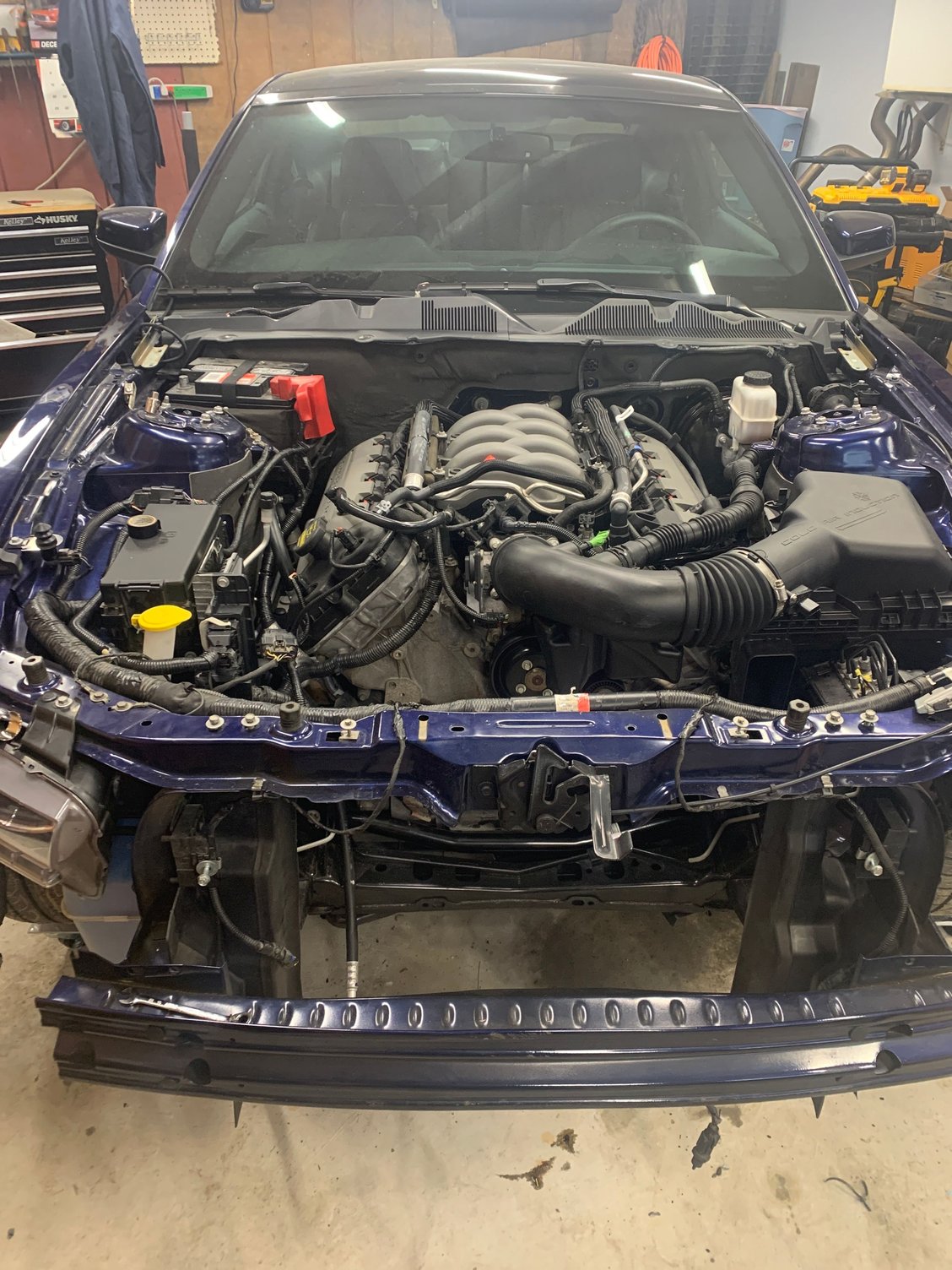

Anyways this is the start of a project I have been dreaming of since I got my car in 2013. I have finally purchased a used 5.0 with 68K miles from The Parts Farm (no clue if they have an account here), Either way Rob has been great and very patient with my excitement for this motor. This has been the worst wait of my life and its getting worse so I decided to share my excitement with all you fine folks on the forums. Anyway I have heard it all before, Fords told me I cant put a nav in a non-nav car, Cant replace the gauge cluster, was told by a body man a glass roof wasn't work the time and money to put in (totally way by the way) and looking through other threads where people brought up this topic of swapping their 3.7 for 5.0 they were told this was a waste of money and time and too go buy a supercharger, or trade in the car for a v8. Unfortunately for me this was never an option, too much emotional attachment (father and I spent a lot of time with this car) plus with all my added packages at this point it would be extremely hard/rare to find a car equipped like mine 401A interior, Glass roof, Nav, Shaker 1000, Backup camera, literally everything but Brembo brakes, and Recaros. Not to mention would never find a 2013 in Kona Blue Metallic. I also didnt want a v8 for the power or I would just supercharge the 3.7, I really want it for that v8 sound, something you'll never get with the 3.7. Here are some photos of how she looked before the swap

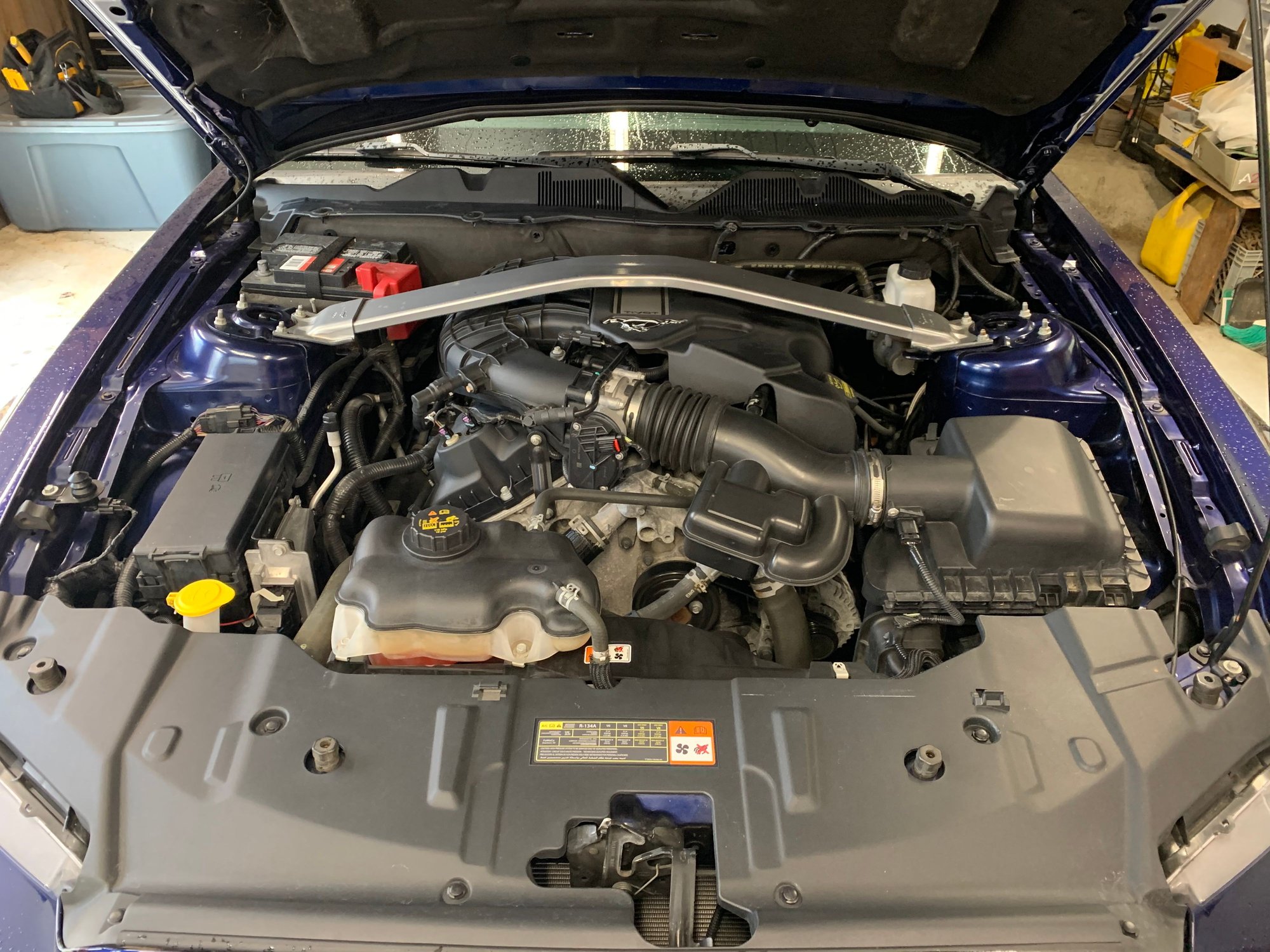

one of the only photos I have of my stock 2012 mustang, how I bought it.

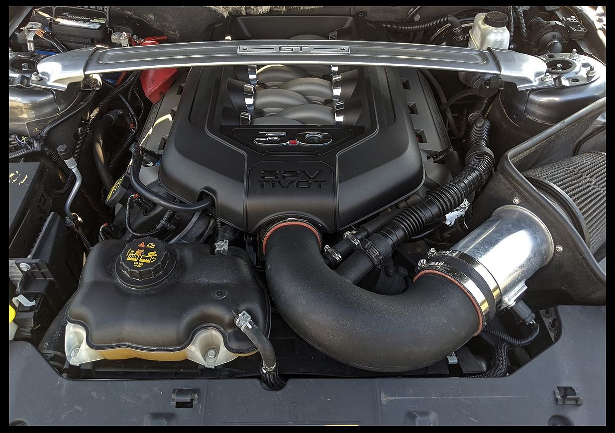

How it sits now my GT Clone or 3.7 GT Premium
Old photo, This was before I put the 401A shifter on
Anyways everything worked out fantastic and I was able to buy a Gen 1 2013 mustang GT drivetrain from The Parts Farm on the 14th of October. Still awaiting delivery of it as of 11/05/2020, It was a fair deal and had free shipping. I then started to (prematurely) pull my old engine and transmission out. So far engine and transmission is out, I took them out separate as space was an issue with the engine hoist, However I am going to try and put the new drivetrain in as an assembly. I havent taken the old engine bay harness out as I want to pull the old one while I put the new one in, However the engine bay harness is disconnected from the SJB and driver side pedals and connector, something which can be done with the dash in. There is one wire I will have to run, which if for my security package hood switch, which the new harness probably wont have. I have tons of orders out with tasca and my local dealership.

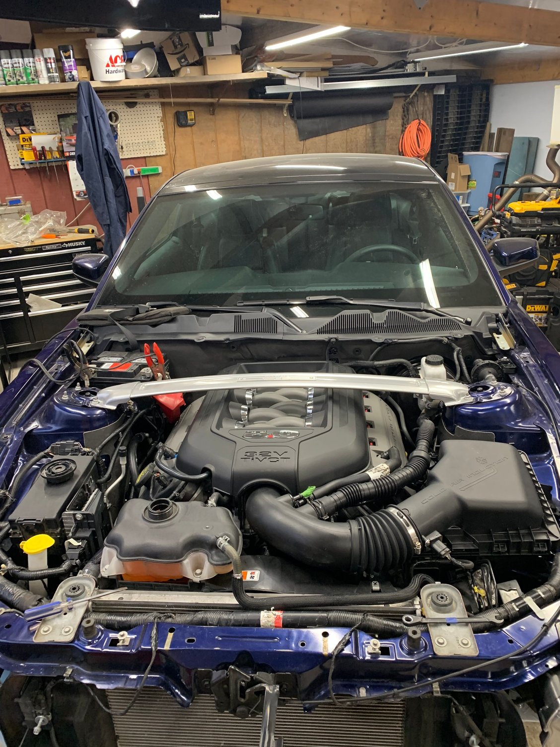

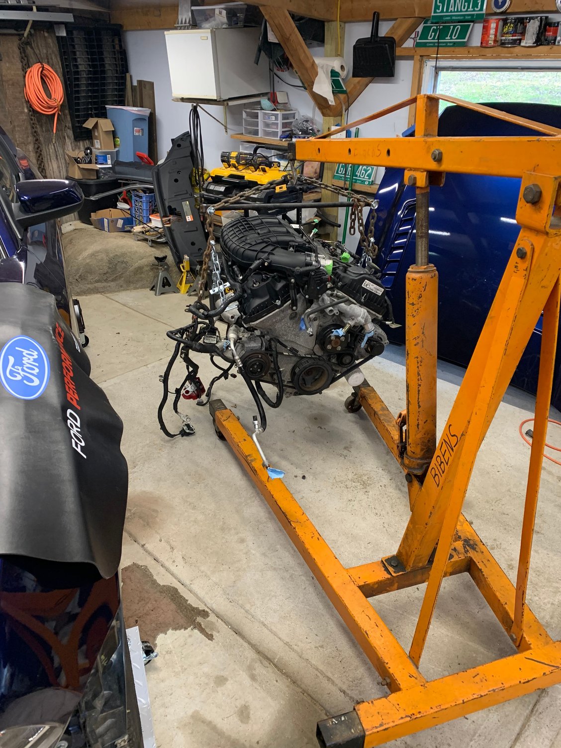

Donor 5.0, going to change that CAI to the stock airbox
Farewell old friend you served me well for 48K miles

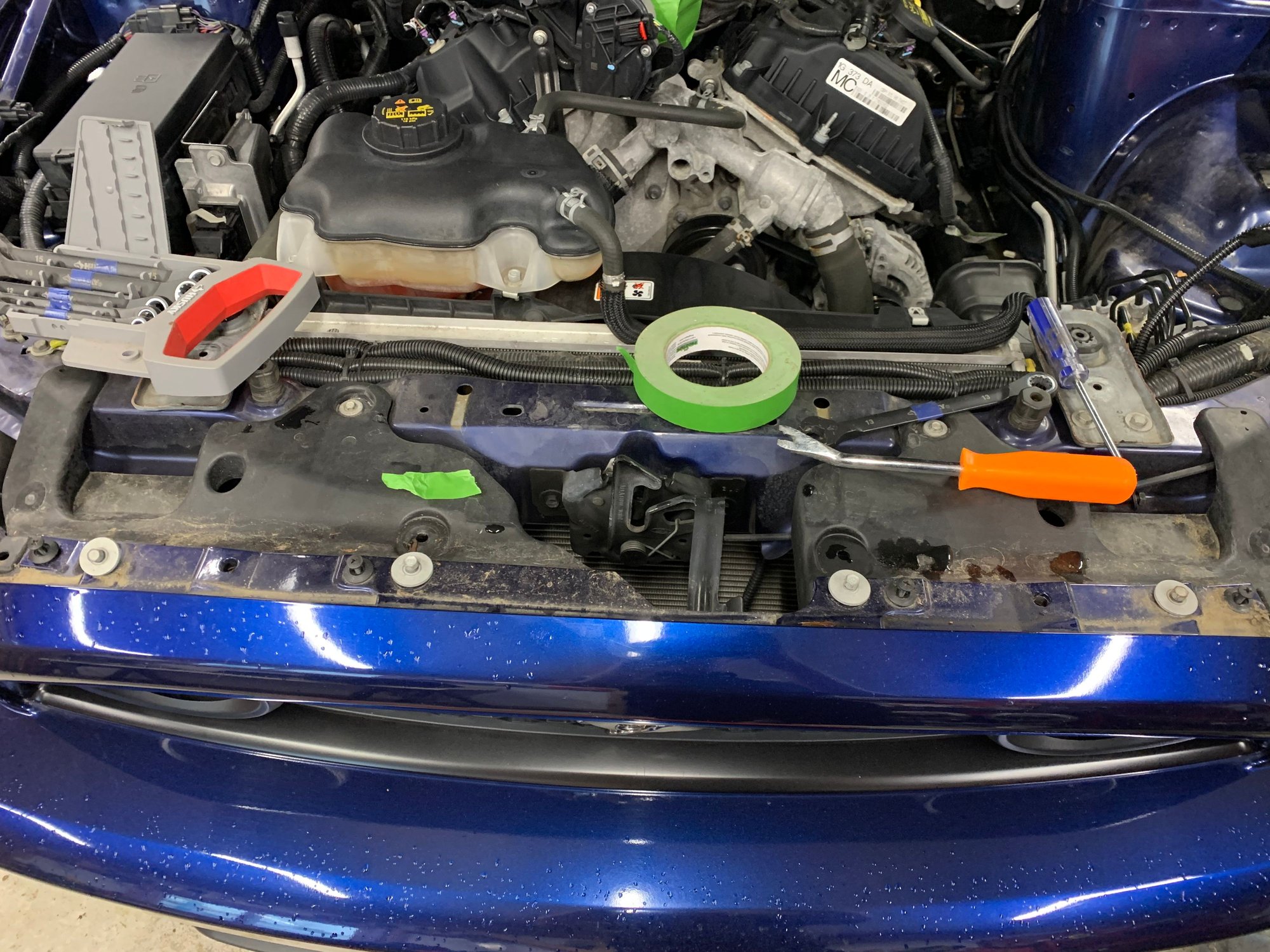

removing bumper
stripping things out, bumper removed

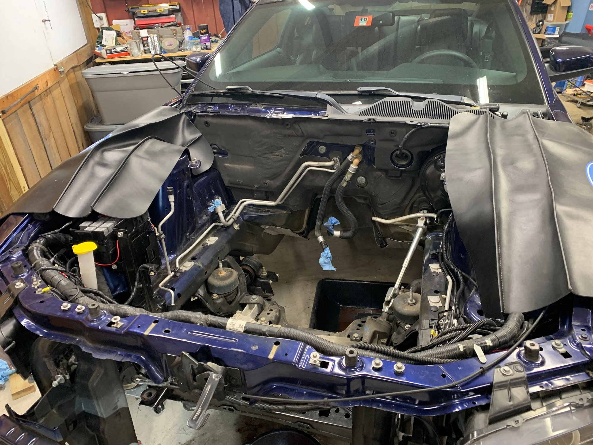

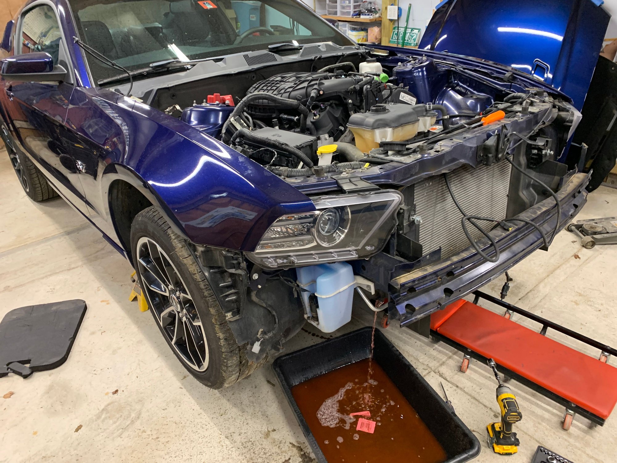

Draining radiator, probably should have been on a more flat or downhill angle oh well.

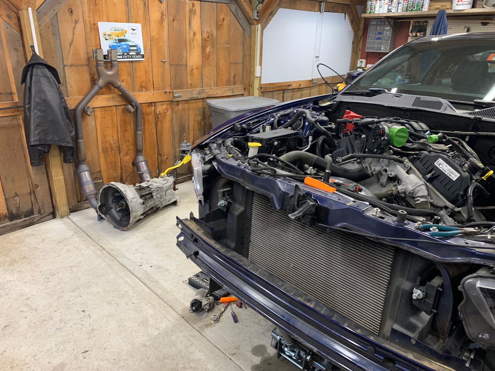

Tranny and exhaust removed (v6 and v8 mt82's are different)

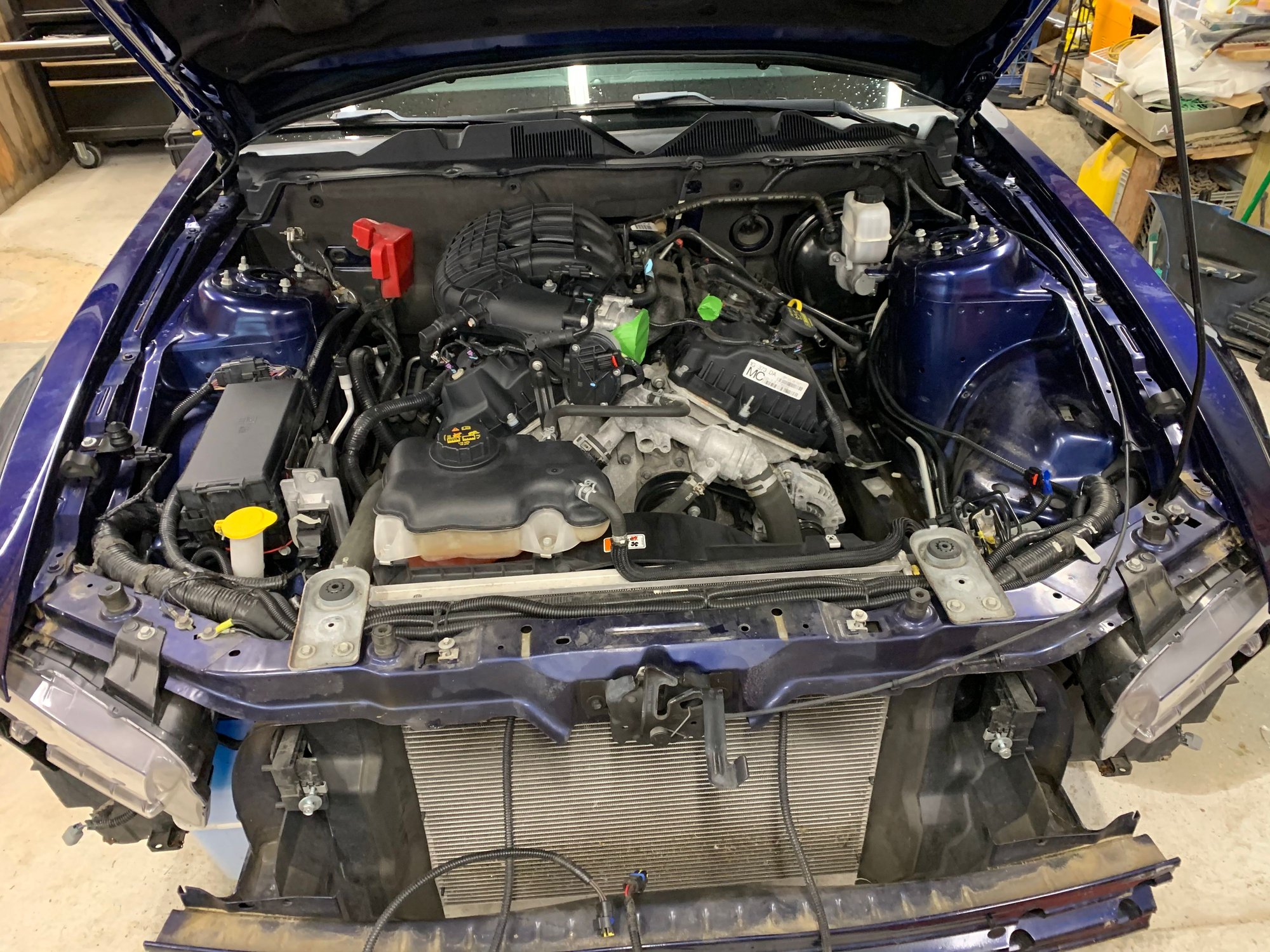

Radiator out, you can see the motor is leaning back pretty good
Motor out
Here you can see sorta where I attached to remove it.

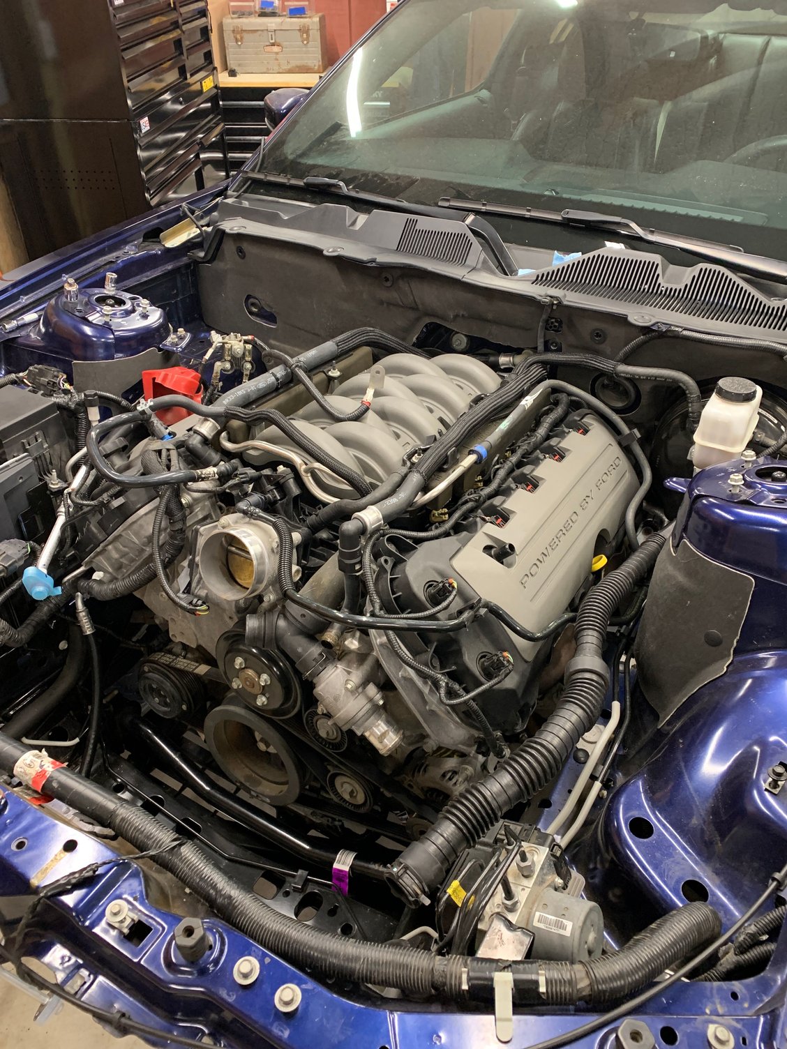

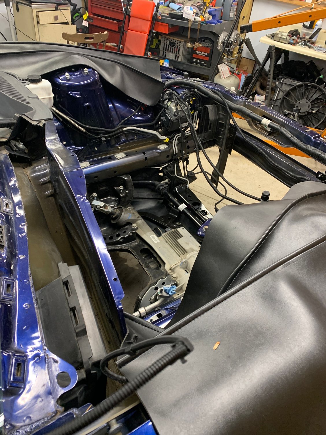

Waiting to clean up the wiring
Started to clean up the wiring, but I added the strut tower insulators that the v6 and early 2011 v8's were missing, first time I ever got that GT brace to fit, the lines I have left in the car are the ones that can be kept, you can see I put the new 5.0 fuel line in however.
Steering shaft will need to be unbolted and moved to the side to make room for the wider 5.0.

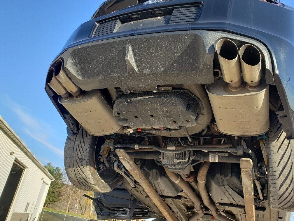

Now for the exciting part, on top of securing the 5.0 I was lucky enough to see The Parts Farm also listed Boss 302 side pipes off a recently stripped Boss. This was awesome for me because my dream exhaust setup has always been Quad GT500 axle backs, GT500 over axle pipes, Boss 302 H pipe and side exhaust, stock manifolds and cats. On my v6 only part of this setup I was running was the GT500 quad exhaust as I felt I would be doing the side pipes a disservice by putting them on the v6, and I didnt want to waste a kit. Now that I want to add them you cant find a kit to save your life and calling for you can only get the H pipe the side pipes are backordered with no ETA. So I grabbed those up quick. I was also lucky enough to see Midway Mustang had just purchase a beautiful 2014 GT500, and the rear end was untouched, I NEEDED the exhaust from it as Ford was only selling the over axle pipes the axle backs are backordered with one dealer in NJ having 5 driver side mufflers but no passenger mufflers in the entire country. And as luck would have it I managed to snag them, absolutely unscathed, Big thanks to both The Parts Farm and Erik at Midway Mustang for everything they are doing for this project, this really is a dream come true. I have parts coming for the boss side pipes as I see they are missing things like clamps and bolts, hopefully the GT500 exhaust comes with everything I need. Now if I can get Ford to change my vin to show it as a 2013 GT premium, doubt it would ever happen. More pictures:
Boss Side Pipe kit, replaced the cat deletes with factory cats, as I don't want cat deletes.
Axle backs and over axle pipes pristine condition

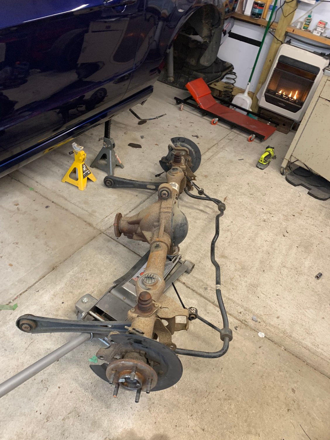

Update: Motor has shipped, I also bought the entire rear differential out of the car (had the 3.73 which I wanted) I was going to have to rip the v6 one apart to change the pinion flange which is different compared to the v8. So instead I am just going to unbolt my rear axle and bolt the new one up. Stay tuned for more...should have motor in and running next week.

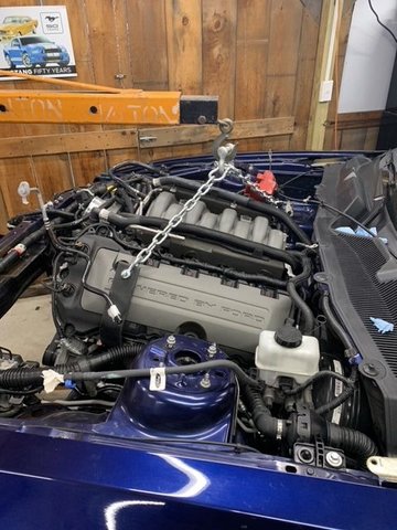

Now for the good part. Install is hard to replicated because everyone's setup will be different, With two people I managed to get the motor and transmission in with a engine jack and without jacking the car up at all. Was tough but just go slow. Steering shaft needs to be out of the way or you will hit it with the exhaust manifolds. The transmission will need to be supported by a jack so you and level the motor out, or you wont get it to go far enough back to line up with the motor mounts. After the motor and tranny is bolted back to the car, time to start connecting harnesses and hoses. I had lots of engine bay ref pictures from a 5.0 to help me run everything right. Also connected the AC lines back up and removed the fuse and relay that controls the condenser until I can get it charged. Once I made sure all of the wires were connected I went a head and put the intake (need a new intake hose as they gave me one for an automatic and it came broke) on loosely to start her up for the first time to make sure she ran. At first pats was blinking like crazy so I figured I needed to program my keys, IDS wouldnt let me and was showing a super old key in PATS relearn, Then It hit me they probably changed a line in the PCM that controls pats to a car that had pats optional from the factory, Sure enough key in and turned it and she fired right up. Im thinking I can get pats back by reinstalling factory data into the PCM but Im not sure yet. Would hate to not be able to start the car if Im wrong. Also before starting I hooked my clutch line back on and put the rear O2 sensor on just dangling because there are no cats. After I knew the car ran fine, I shut it down and started to put the radiator in and some of the front end parts, all in all putting the v8 in a v6 car was not hard, and so far worth it. I will keep this updated as I start fixing problems. Now for video and pictures.
Motor almost in
Motor dropped in still need to sort wiring
Wiring all sorted out, about to start it for the first time

Filling the radiator engine bay mostly buttoned up
Motor Idling All Dressed Up, Waiting For Coolant To Cylce:

Old axle dropped out

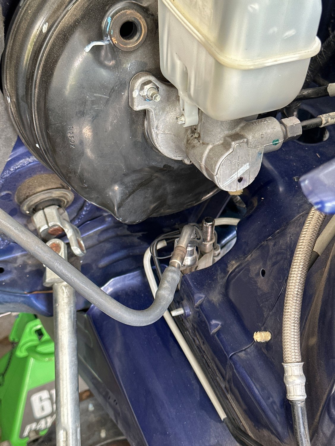

I’ve been following your work ever since I got my V6 Mustang in 2014. I finally scored a 57k mile Boss 302 to put in my car (doing it now). I am having trouble finding the fuel vapor hose for my engine, and can only find the regular GT fuel line. What did you do for the vapor line? I saw it was taped off in one of your pictures.
Fuel and vapor lines
