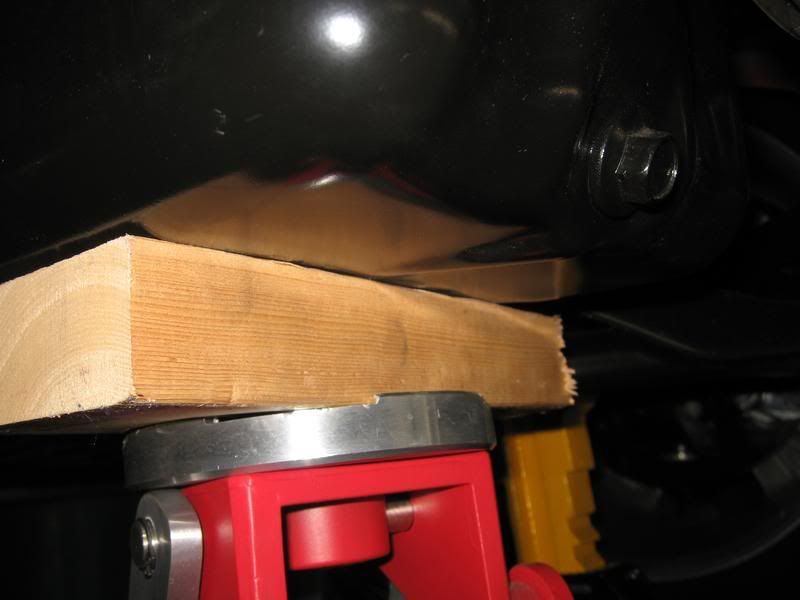

5. The engine will need to go up approximately ¼" to replace the mounts. Using a floor jack, I used a piece of 2x4 wood and carefully placed it under the oil pan, just forward of the drain plug. Be careful not to place the 2x4 under the drain valley of the drain plug.
Jack the engine up only ¼".

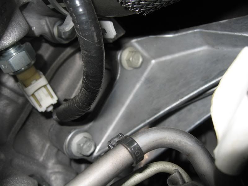

6. Locate the engine support bracket and remove the 4 bolts attaching it to the engine block. Use of a swivel socket and long extensions may be necessary.

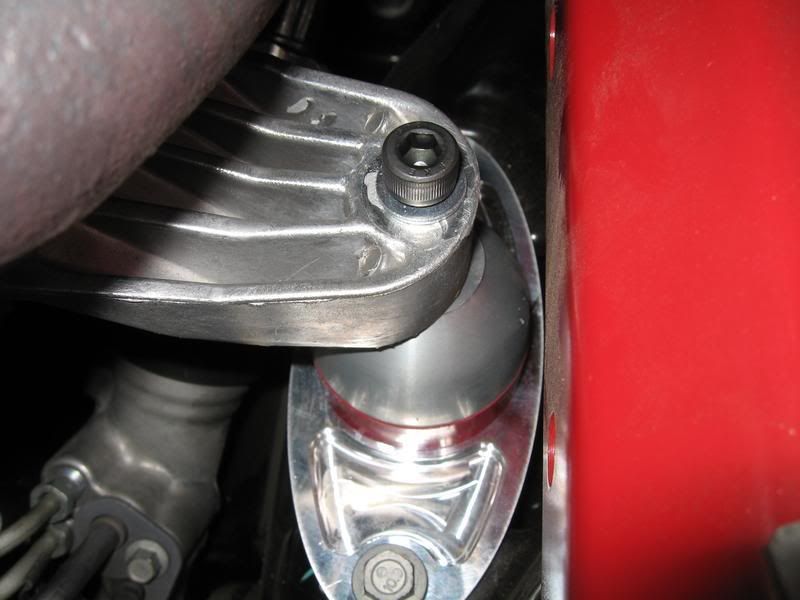

10. Apply anti-seize lube to the supplied socket head bolt (with the supplied silver flat washer) and install it though the engine support bracket and the Prothane mount, hand tighten only.
11. Lower the engine back down onto the mount.
Torque the 2 side mounting bolts to 41 lb-ft.
Torque the center socket head bolt to 30 lb-ft.

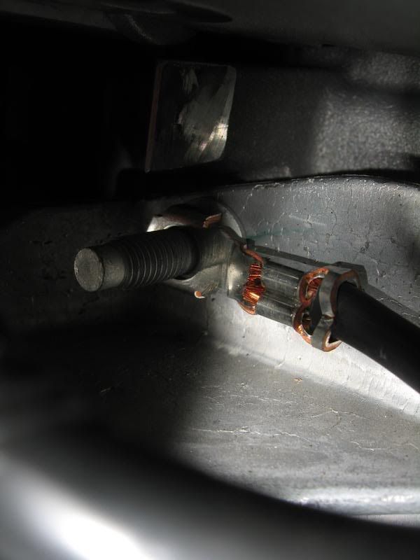

The top-aft fastener in the engine support bracket is a stud bolt. Nothing was attached to mine; deep well socket is needed to remove this bolt.
Note: Take note on how close the starter cable is to the bracket; this is the reason why the Negative battery cable is disconnected.
The top-forward fastener in the engine support bracket has a ground cable attached to the stud bolt. The cable must be removed first prior to removing the stud bolt. Access will be tight because of a wire conduit, but it can be done.

  • After installation of the mounts is complete, be sure to measure the distance from the outside of the mount to the frame on both sides. The aluminum mounts have a lot of clearance around the bolt and the engine may need to be centered between the frame rails. If so, loosen the socket head cap screw, use a bar and pry the mount towards the other side of the frame until it is centered, then retighten the socket head cap screw. This is usually the problem when the headers contact the steering shaft - the engine needs centering in the frame
  • The stud on the passenger's side which has nothing attached to it is for the bracket for the automatic transmission cooler lines. 5 speeds don't have anything attached to this stud

My engine was lucky enough to come centered from the factory as I did eyeball the side to side clearance and it looks to be about the same.

Do you remove the engine support bracket while under the car? I looked yesterday while preparing a plan for doing mine, and I notcied you cannot see the bolts on the bracket on the engine side while looking from above.
Thanks,

Yes, remove while under the car, with the engine supported by jack and/or jack stands.

Thanks. I printed out the post and have gone through it, and just wanted to make sure as the pictures perspective were not 100% clear.
