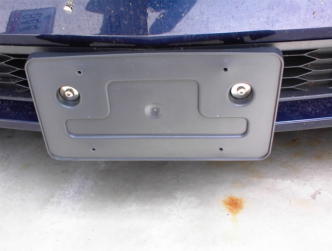

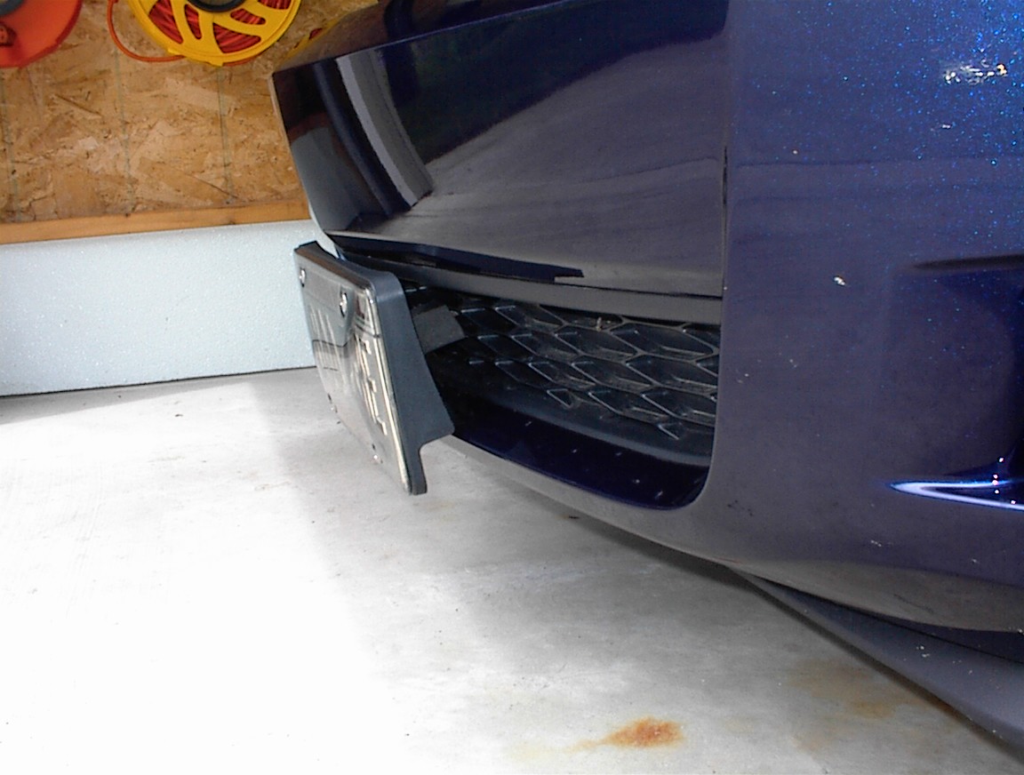

Rigged up the factory front plate bracket to mount to the lower honeycomb grill.

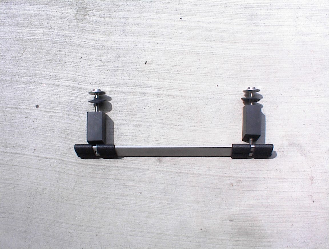

1) I found some rubber oil cooler mounting blocks in my junk box (approx. 7/8" x 1-1/8" x 2" long with 5/16" hole thru center) and cut a 3/8" wedge off one end to match the lower grill angle (1-5/8" long top / 2" long bottom with the 1-1/8" block dim vertical).
2) Then cut a strip of 3/8" plywood I had laying around to 1-1/2" wide x 11" inches long.
3) Drilled 2 1/8" finder holes in the plywood at the same centers of the bracket mtg. holes.
4) Removed the upper flat panel between the top of the grill & radiator support to gain access to the back of the lower grill.
5) Then used 2 4" long drywall screws with big fender washers at the bracket that pass thru the bracket, the rubber blocks, then thru the honeycomb grill and into the plywood behind the grill.
** Note that bracket is installed up-side down compared to how it normally would be mounted to the bumper.
Kind of a pita getting it lined up, centered, and level but the effort was worth it to avoid holes in my bumber cover !!

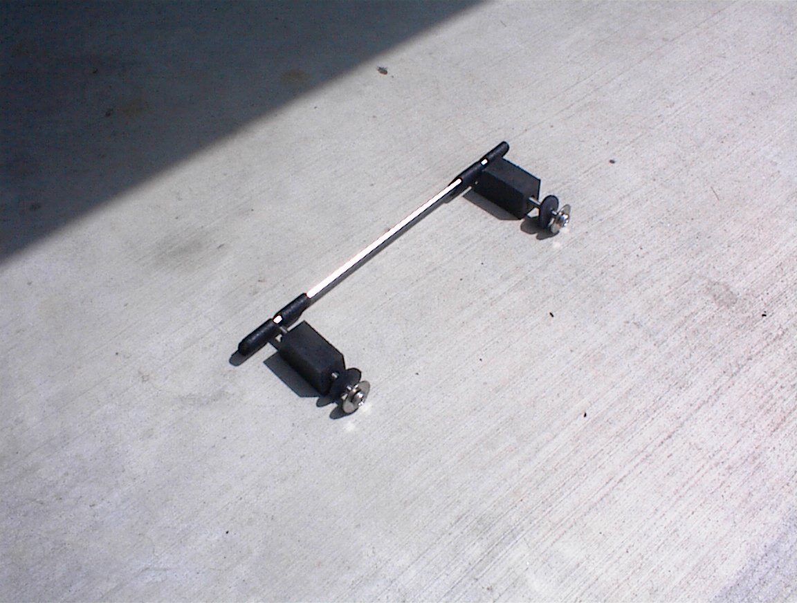

Converted over to "Stainless Steel" mounting hardware today.
* Strip of 1/8" x 1" S.S. x 11" long (cut from a piece of 304 S.S. I found at work)
* 2) 18-8 S.S. M6 x 90MM Long Pan Head Phillips Screws (McMaster Carr # 92000A470, $5.03 per pack of 5)
* 2) 18-8 S.S. #10 Size 1" O.D. Fender Washers (from local hardware store, $0.19 each)
* 2) 1" O.D. x 1/16" thick rubber washers (made from rubber sheet stock) to go between plate bracket & Fender Washers
* 4 Strips of 1/8" x 1" Adhesive Backed Closed Cell Neoprene to wrap around ends of S.S. Strip (roll from McMaster Carr); not really neccessary but help in positioning / holding strip in place as you tighten down the screws.
* Mark the 2 mounting holes in the S.S. strip 8-11/16" apart (centered).

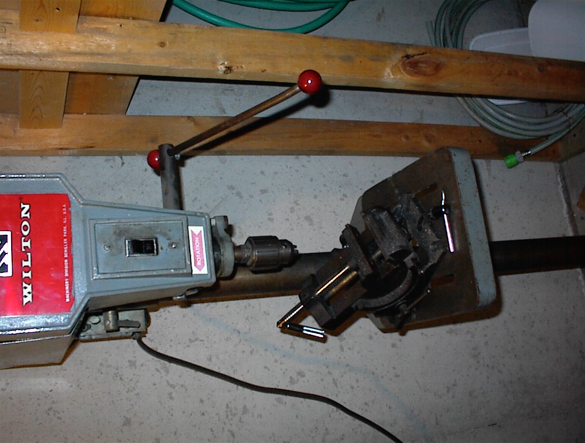

* Drill the 2 holes using a 5MM drill (at 90 Degrees 1st).
* Then put it in the angle vise at 30Deg off of 90. With a hand drill run the drill bit thru starting at 90Deg to the strip and slowly work the drill bit until it is vertical and 30Deg to the strip.
* Now comes the tough part ... tapping the M6x1 thread on a 30Deg angle !! I chucked the tap in my drill press and with the chuck key slowly turned the chuck by hand ... use plenty of tapping fluid (in my case at home ... motor oil). 1st one went pretty smooth, but went too fast on the 2nd one and broke the tap. Got the broken part out and somewhat salvaged the tap by grinding down and re-chamfered end. With this fixed tap I had to go extra slow, but I got it to finish the job.

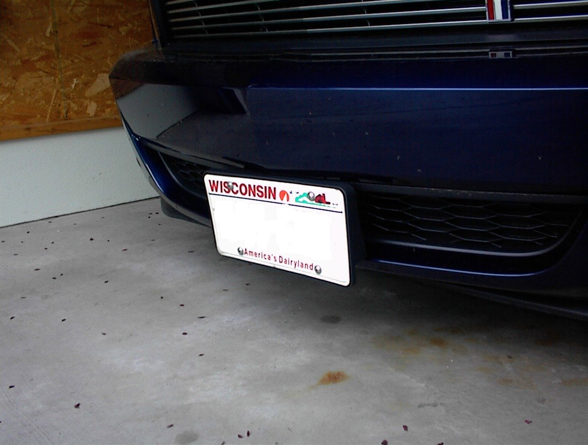

** One other thing ... plate bracket is NOT UP-SIDE-DOWN as I originally stated. As I was taking the pics & putting it back on I noticed the Ford writing on the back was right-side-up. Sure enough, my top IS the original top ... don't know why I thought it was inverted.
Pics below ...
