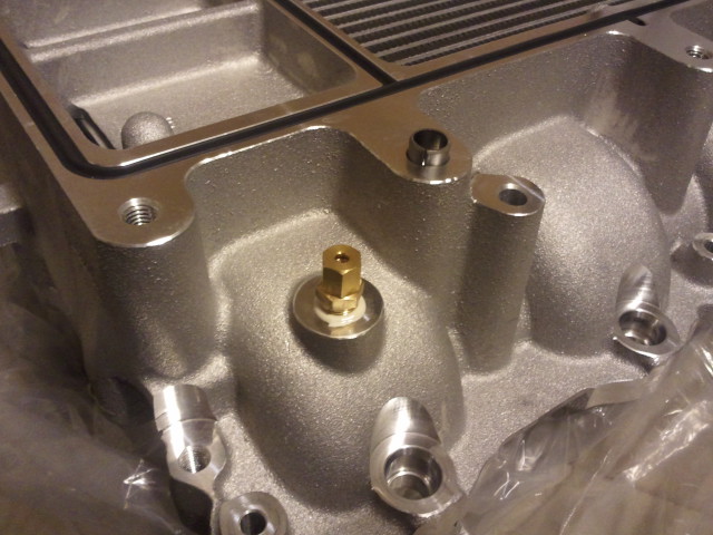

Where do I "T" in vaccuum line for boost gauge?
Poking up a boost gauge for my blown 2011. Wondering if anyone has done the gauge install...which vacuum line under the hood did you tap into?

On the intake manifold passengers side, there is a plug you have to remove and install the proper fitting.
where can I find the fitting? ANy drilling involved? Thank you!

1/8' NPT fitting. I got mine at home depot.
