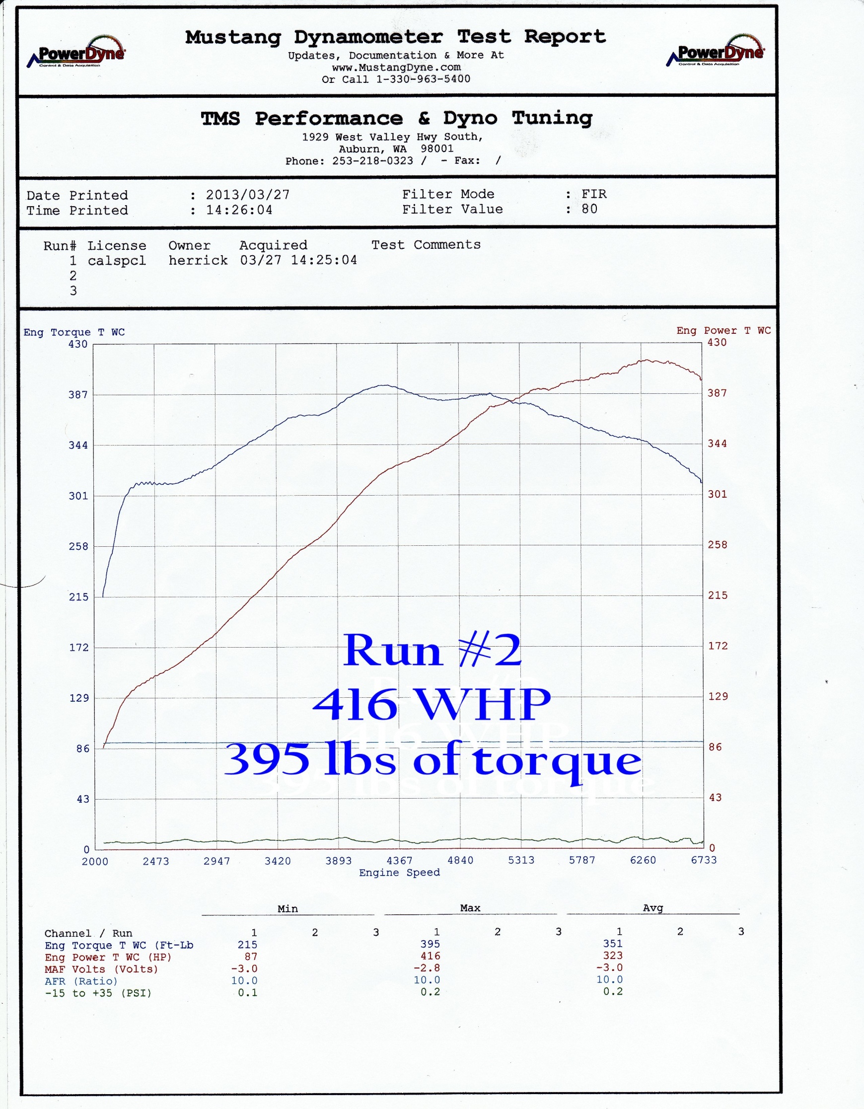

I added a JLT CIA and an SCT tune and estimated 50 to 60 hp gain. I added an 85MM throttle body and estimated about 20 HP. I added Ford racing x-pipes and exhaust but did not add hp gain because it would be minimal. So I estimated my engine at about 480 HP. I did a dyno run and produced 416 at the wheels. take that plus 15% for drive train loss and it put me at 478.
you may see more or less depending on how things interact with different brands and such. The real benift of these mods was torque. torque is what makes it responsive and more fun.
