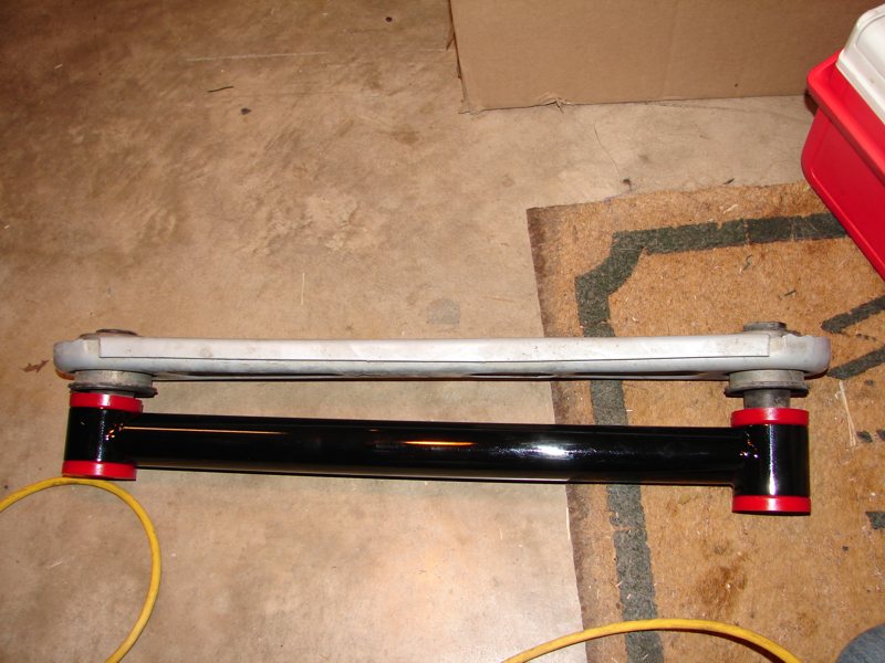

I installed the LCAs this afternoon (but won't get to try them out till tomorrow- its pouring outside for the first time in, well- since last year).
It seems every time I work on one of the cars, I get a new tool that I don't know how I've done without... This time, I picked up a 1/2" drive breaker bar. This thing is DEFINITELY going to come in handy- should have gotten one long ago!
Pretty easy swap, although I was a bit surprised at how tight the bushings are width-wise at the front mounts. Once I decided it was "just gonna go in," it wasn't too bad- but man its a snug fit. 129 ft/lb is "pretty $#@& tight!" I'd never have gotten there with my big ratchet. I couldn't fit my digital torque gauge in for the front one, so I did the rear then torqued the fronts to the same feel. That stupid plastic guard at the front of the wheel well is a real pain!
Took a comparison pic. If this doesn't take care of the wheel hop, I'll probably order one of the upper arms and just replace the arm leaving the stock mounts. Spending some time looking at the rear axle, it seems to me if you delete movement at the top OR bottom it should resolve most of the unwanted axle rotation, but creating less movement at the LCAs should help more in corners (but I could definitely be wrong).

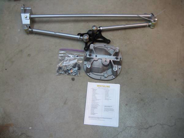

I've been following your install and big Thanks for your info. I'm kinda wondering myself on replacing my LCAs. I've decided to slowly add Whiteline parts. The big install is my Watts Link. I'm hoping with the watts, it might be enough to forgo UCAs and LCAs. But we'll see.
