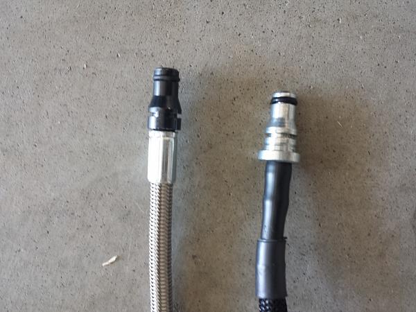

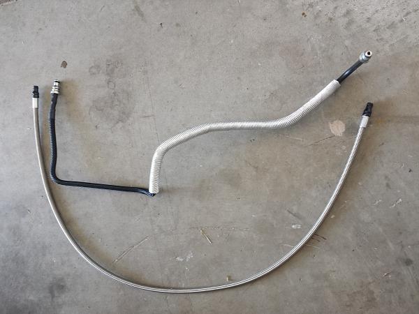

Just installed the SR fluid clutch line not to long ago and I change the tranny fluid to Royal Purple Synchromax and let me tell you the clutch pedal feels 10x better and shifting is buttery smooth. I mean the MGW made things way better than stock and changing the clutch line and tranny fluid was like the icing on the cake! Install of the clutch line was simple and I did everything from the top of the engine. The most annoying part was having to pump the clutch pedal so much.
