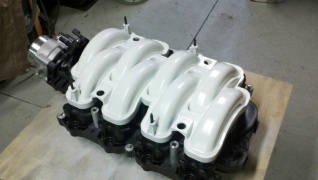

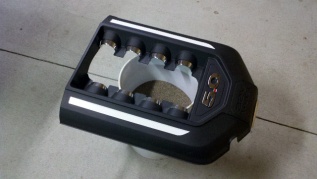

Wow, great job... Looks awesome. I bet this would looks equally as good with other colors as well.

Looks good!

Nice job! What kind of paint did you use?
Dupli color exact match Performance white. I prepped and sprayed with plastic adhesion promoter first. I have driven around and got warm and checked it. I will say the intake really does not get that hot so I don't forsee any issues with it.
