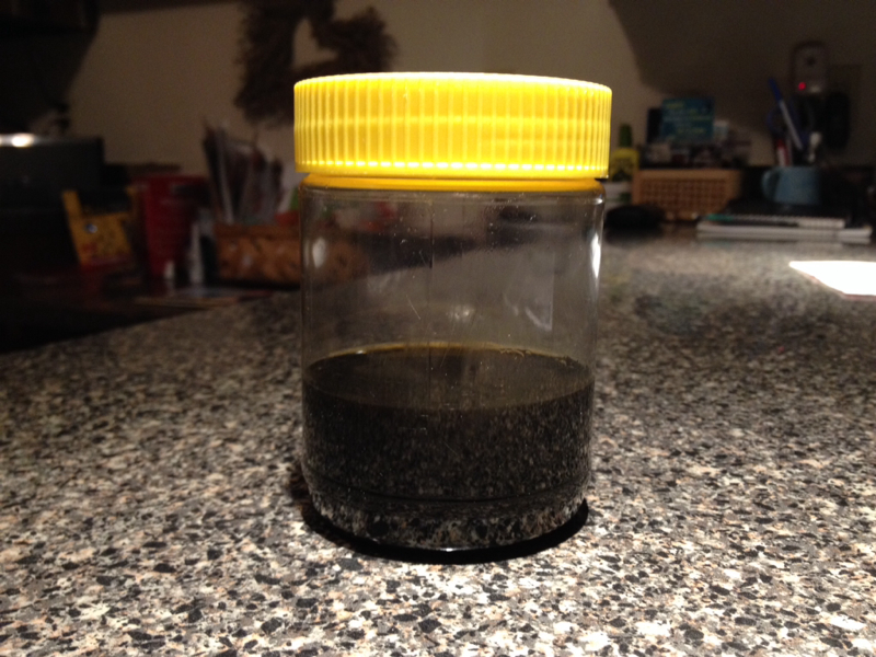

This is after 5500 miles with the new JLT...it's about 4 ounces worth.

If you have a jlt, check the hose going back into the intake manifold, the 3 cars I personally saw with the jlt's still had oil in that line!
But they were the old jlt separators!
Mine and the other car that I looked at with the moroso had none!
I'm wondering if the new jlt separators are better than the first ones!
