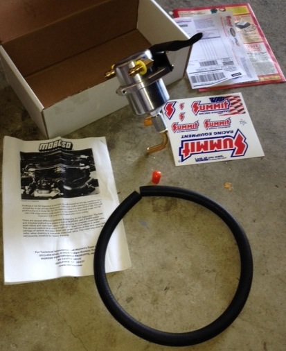

I got my moroso air/oil separator today.
I'm just waiting on the factory PVC line fittings.
I don't want to cut up my factory line.
Parts should be here Monday!

I just put my Moroso air/oil separator on!

Well checked it tonight after only 250 mi.
I can not believe everyone does not put at least some sort of oil separator on there car!
Who would want all this oil in the intake manifold!
I checked the line coming out of the separator at the manifold, not even any oil residue completely dry!
This thing works great!
