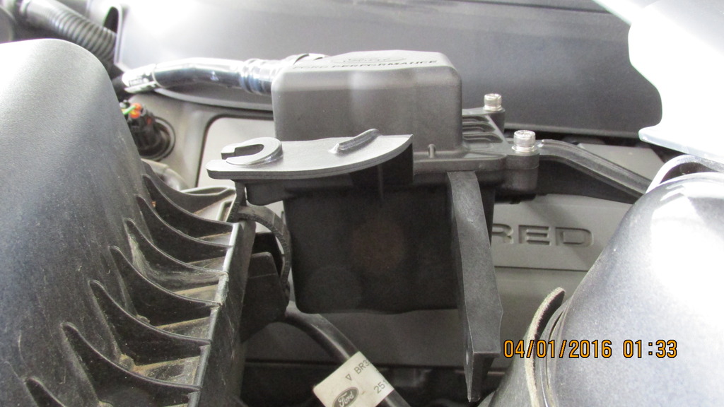

I received my driver's side Ford Racing separator today and installed it. I did not do any modifications to mine like Samjluck did to his as I found that the separator seemed to stay where it's at with no movement. The lines are pretty rigid and since the separator is pretty light since it's plastic and this can will probably not catch any liquid oil, I don't think the weight of the separator is going to stress the lines or the barbs coming off of the separator. I wanted to keep my separator intact in case I want to sell it in the future.
Here are some pictures of the install.
The install was very easy but I did have to play around with the line going from the separator to the intake tube to get it in the right position.
Wayne
Wayne
