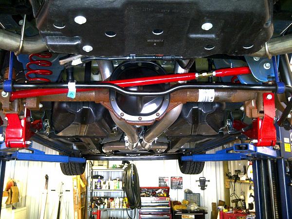

An adjustable panhard bar is necessary to center the rear once you lower it.
Even at just 1 to 1.5 " low ?
Not always. 1.5 drop might need it
Yes.
Wrong. The car will not be centered.
Yes.
What brand do you suggest ? A link will be great
Yes.
Dropping an inch does NOT need a panhard bar. PERIOD but I have a bridge for sale if you're interested
BMR.
