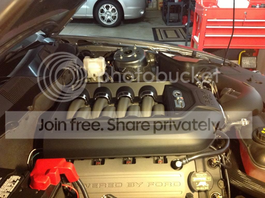

I love my MSD 2-Step. I currently have mine set at 4200 rpm with t/c on because I am still on stock rubber. Depending on the street the launch can be perfect, or it will bog slightly and pick right back up.
Attached Thumbnails MSD 2-Step Launch Master - consistent launches?-image.jpg
Old Jan 24, 2014 | 06:17 PM
NoSlo5oH's Avatar
Joined: October 30, 2013
Posts: 50
From: Midwest
Not only does it sound intimidating, it also fits nicely under the intake cover.
http://i1351.photobucket.com/albums/...psf30a9d44.jpg
http://s1351.photobucket.com/user/10...1ca46.mp4.html
