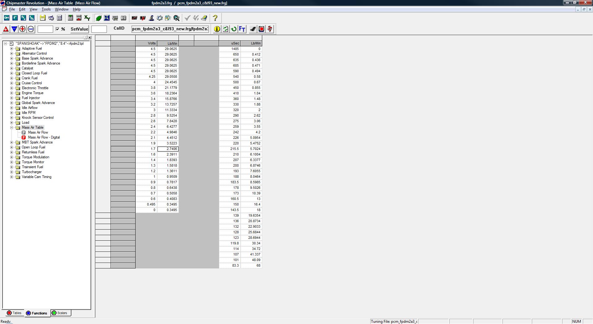

Can you post what the factory MAF curve is on a Stock 11-12 GT? Trying to adapt a Coyote slot meter to my Fox body. I've got the hardware, wiring and a Tweecer, now I just need the numbers to crunch.
If anyone else has this info, feel free to share it as well.

Here it is in Diablo Software...
